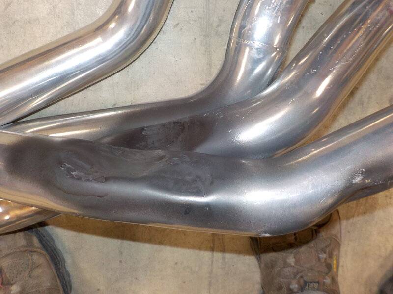

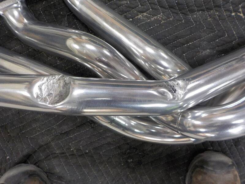

I bought a complete exhaust system from TTI this Winter for my '66 Satellite with 572 Hemi and TF727 . Had to wait 3 weeks to have an O2 bung put in passenger side and the ceramic coated , everything arrived ok . Then the chaos of trying to get them to fit began . Passenger side hits 2 crossbolts and also the " bellhousing " portion of my 727 . Ok ... in and out maybe 5 or 6 times to get them to fit . Drivers side ........ hits 2 crossbolts that take 4 or 5 installs and then the shitshow of fitment for the starter area really gets going . Using the starter that TTI recomends ( Powermaster 9523 ) I tried 2 different clocking positions and there was no chance of any fitment . So............... 8 hours of heat , beat and repeat ( just like forged in fire ) I finally get the drivers side to clear the starter . Cylinders 1 and 3 pipes both have baseball size dents 3/4" to 1" in depth . The headers fit fine against the chassis , matter of fact there is so much room the could have easily adjusted the pipes to the outboard to clear everything . Car has a Gerst coilover front suspension and the headers are the model for that modification . I now have a driverside header with plenty of dings and scratches from the 25 times in and out that it took to get it to fit . 2 emails to Mike at TTI about the issues and no response !! I have had many sets of headers since 1977 and even built some race headers myself , but never had as bad of fitment and lack of customer support as this . All for $ 1200 plus the rest of the total kit !!!

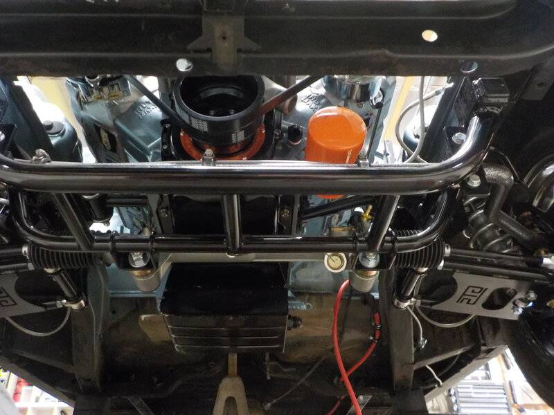

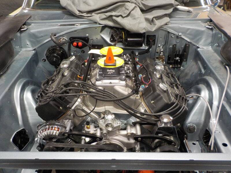

I don’t blame you for being unhappy with those headers. A Hemi makes everything a tight fit but a good part of TTIs reputation is built on their ease of install and trouble free fit. I would think about telling them you would like to return yours to them with the hammer modifications and ask them to make up a set that clears as it’s supposed to. Is your motor on an original Hemi k-frame or is it on aftermarket mounts on a BB k-rame? The
I installed a Gerst front suspension which includes a tubular k-frame and coilover suspension . I can't say enough about the quality of the construction and service from Carl Gerst - top notch !! Everything involving the front suspension and engine installation went great , I used the spool engine mounts and engine location is in the stock location . Trans lines up on original mount . With the lack of torsion bars , header installation is much easier as is installation of most everything else . Yes I would have loved to sent my headers back to TTI to show what they could improve on , but that does not seem to be what they are interested in . In my emails to them I included photos and detailed explanation of the problems .... and I was nice about it , no swearing !!!!!!! The rest of the exhaust system fits well ( only 2 places of hammering to clear the gas tank ) . I have several other Mopar projects and none are going to have TTI products - is a shame . At this point my best recommendation to anyone is to by an UN-COATED set of headers , check for fitment ( hammer or reroute tubes ) and then send off to get coated/painted .
