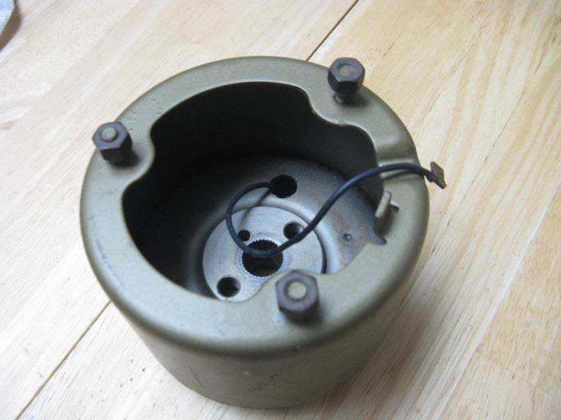

Hey guys looking for some help here. Want to put a Tuff Wheel in my Road Runner. Going to keep the original wheel of course. What adapter collars are needed to put a re-po Tuff Wheel on it. I've only dealt w/E & A bodies 70 up cars, so for them its easy.
Let me know please.
Thanks, Ken

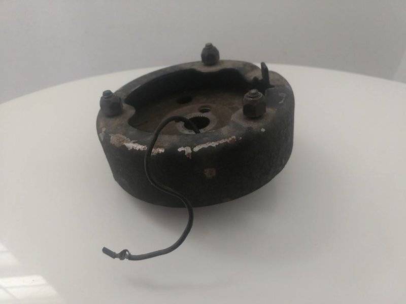

Looks like this. I have an original if needed, the one pictured I sold but have another in black.
Does that flange clear a 68/69 column?
I know it does on a '70.
...and it doesn't on a 66 or 67.
If that's just a standard one like an A & E body that makes it easy. I was thinking the same thing the 68 column's are smaller diameter, but if it works okay
You may have to trim the flange back on the adapter to make it fit a 68 steering column. Flaming river has a billet adapter that may work too.
I could not tell you. I never tried putting one on a 69 & back vehicle. Just posting that is the style he is going to need to modify as the E-body one will rest on his chest...
It is A & B body... Like I said above the E-body can will stick out in your chest..
Thanks for the help, the smallest style appears to be from Grant. Think I will go that route for my project.

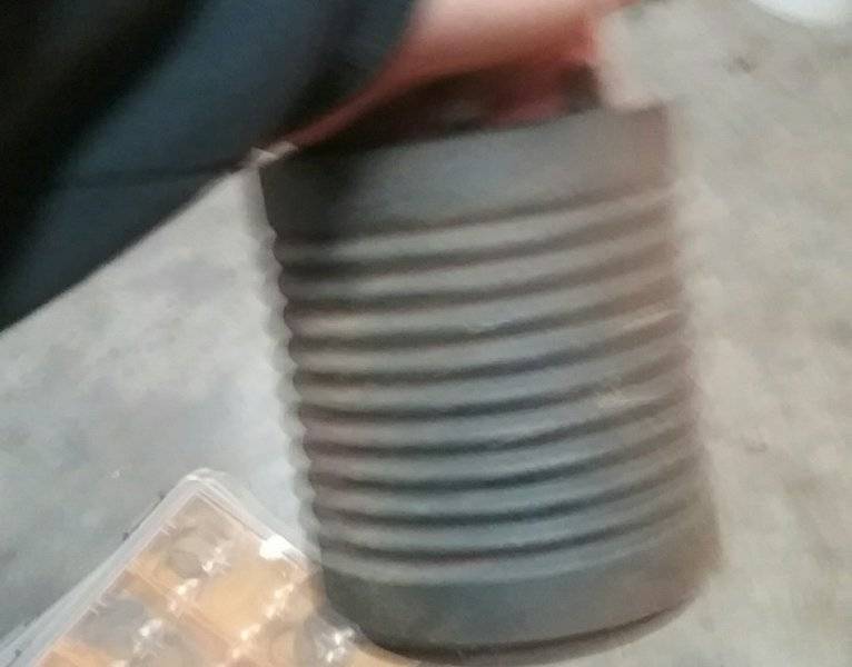

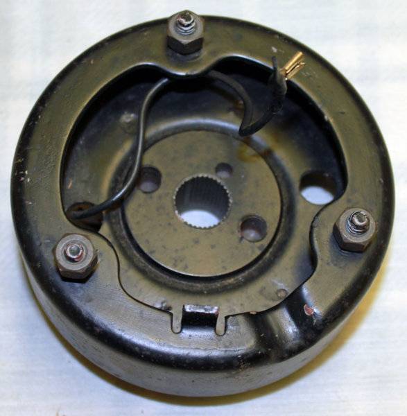

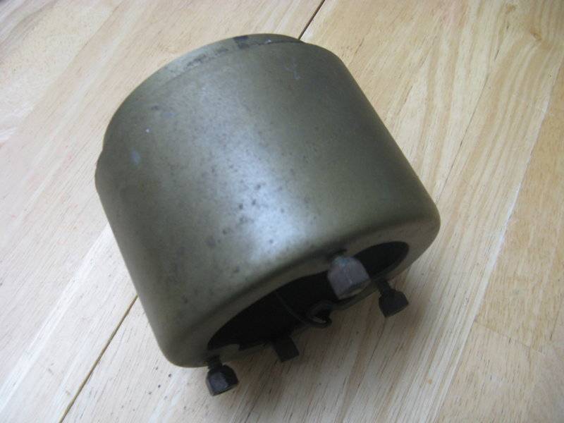

The can that is in the picture above is a a body or truck ebody or later model B body would not be smooth
The 70 and up B body can or collet is the same as the A body or truck can. The longer ribbed can is E body only.

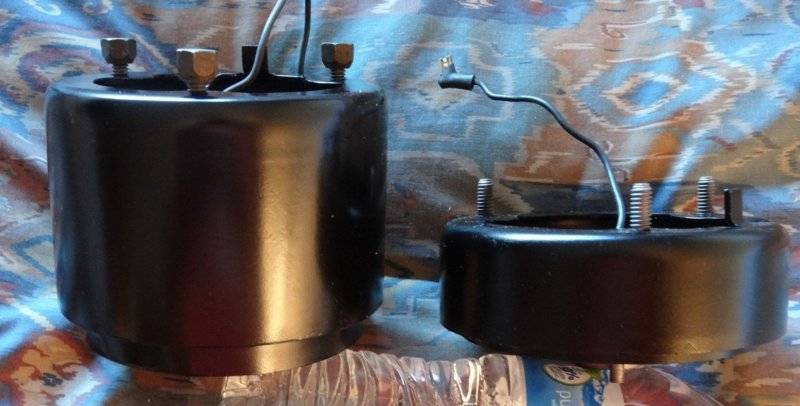

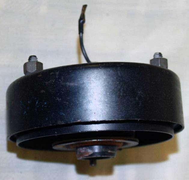

So who here can tell me what the application is for the short tuff wheel can? I now have two of them. Also included a pic showing the standard one for comparison.
short tuff wheel adapter 2 inch pic 2.jpg short tuff wheel adapter 2 inch.jpg short tuff wheel adapter.jpg short tuff wheel adapter.jpg
I have never seen one of those,but I could guess the maybe they are for F body Aspen /Volare,or later Magnum /Mirada?
Could that be a C body rim blow can?
Some truck cans don't have a master spline, but still can be used.
