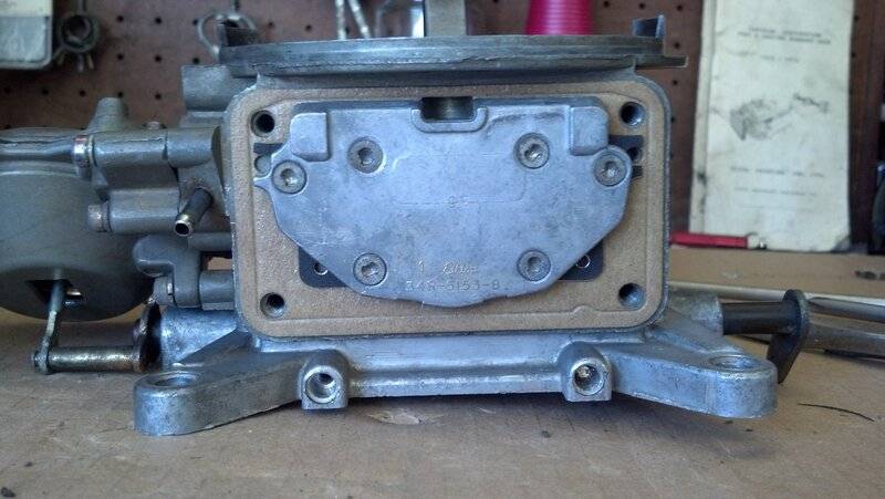

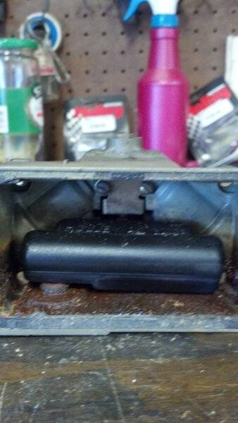

Always do.Use the blue nonstick fuel bowl gaskets you'll love them

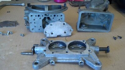

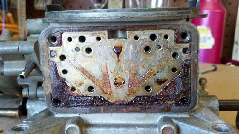

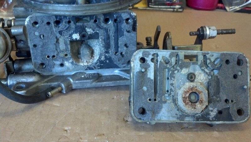

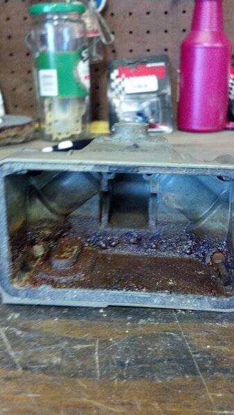

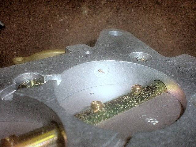

This is what happens when you let gas sit in the carbs for 15 years.
View attachment 981998 View attachment 981999 View attachment 982000 View attachment 982001
http://www.sixpackperformance.net/store/sixpackparts.htmlOnly worry now, is since my #1 Outboard was removed couple days ago, noticed the Brass idle air screws are both stripped.. :-( 1 thing or another. There is NO used baseplate for sale. Like to try keep it OEM as possible.

Please explain what the picture shows.They are easy to fix !View attachment 982193
I’ve never fixed one.They are easy to fix !View attachment 982193
How did you Get them out once bottomed out, and NO screw slot?They are easy to fix !View attachment 982193
Just did, from sixpackparts
I don’t think they do.Just did, from sixpackparts
Mine are fine, but I may need to know how to fix them, especially in the front carb
@62MAX ???Ha! Explain pleaze?
