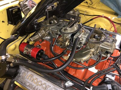

Oh boy, well? I inherited what I never DARED to "Go Near" or could only SHOW my teenaged friends in the 1980's... When I had to sell his house, help my Asshole brother take care of his "Final Wishes" etc, I finally got it into MY garage after finally getting out of the Army in 2008. I knew one day I'd own it. Hating or just disliking a man's Father goes away pretty fast when the inevitable happens..
When I first began to actually take it out & drive this "A12" it ran FANTASTIC. It's a ROCKET, when it runs as it should. Anyway, 3 weeks ago, I ran into long time friend who owns a 68 SS 396 Camaro, (hehe), well? Yeah we know what happens, at even 50 yrs old I was not letting a P.O.S. Bowtie pass this car I've NEVER seen passed by another '60s/'70s Big Block car.. Was always the ol man driving and I usually scared shitless... 10 yrs old? 140 mph? NO SEATBELT.. What the hell was a seatbelt? We all learn that eventually.
After 7-10 short drag races vs this weak-*** 396 (He never has passed this 440 Six Pack since Ive had it).
It falls FLAT ON ITS FACE, when literally "Putting Around", carbs are 51 years old. Todays gas is crap. I've replaced:
DASH WIRING-ENGINE WIRING (Year One), ECU-COIL- BALLAST RESISTOR-WIRES-CAP-ROTOR-Volage Regulator, rebuilt the damn guage cluster! **** works now that hasnt in 35+ years. (Except fuel Guage)... (There IS this, it seems to work) "Hi Rev7500"?View attachment 981662
If I stomp into it, past the cruising RPM? It's a Bat Out Of Hell again..In between? Runs like a 300,000 mile Honda Accord with an automatic.
My thoughts are to just BUY ALL NEW Carburetors. A/F screws are stripped on #1 outboard, Ive rebuilt Thermoquads, QuadraJunks, Holley 750s, but this is my FIRST "Six Pack" car. Pain in the ***. I'm not rebuilding just one, and then have to REMOVE it, to service the other 2 within a few days. This my luck. Lets call it "History". Should have STAYED in the damnned Army.
Advice? IF I can afford to buy at least the Center 4144 and ONE Outboard carb? (For right NOW) Anyway. Im sick of "Throwing Parts" at it. Not looking to sell it...(Yet) but getting there.

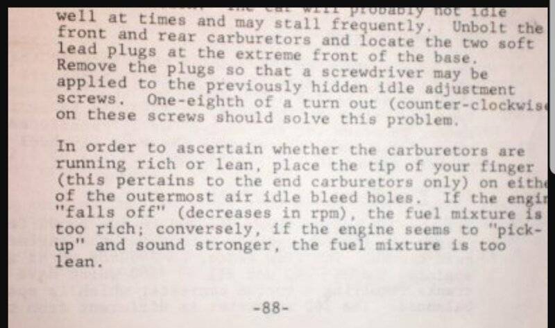

I don't know if I posted this yet, but this, THIS was truly THE turning point in my struggle to get my 6bbl to idle properly, and THAT is the strong foundation that is required to make them run right at every other throttle position.
I first knew I had a problem when I turned the center carb idle mixture screws all the way in, as in no fuel, and the engine ran better! The outboard carbs needed tuning, badly!
Get to those outboard idle mixture screws, follow these instructions, and get going on the path to 6bbl bliss!

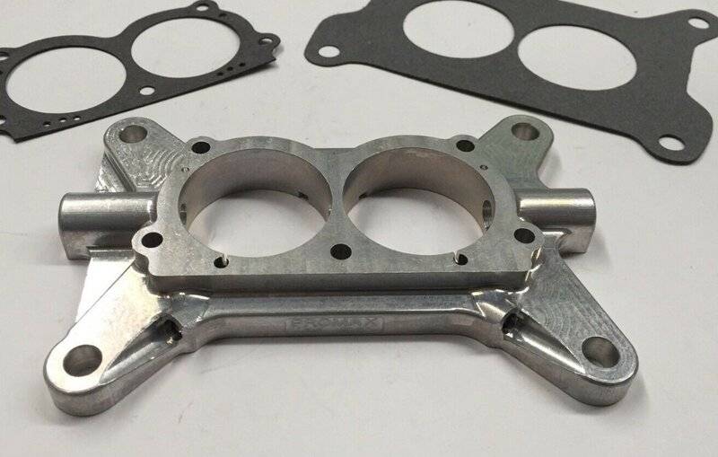

Thank you for that link to Promax! Ordered the rear "Angled Screw Baseplate". $190 Im sure will be well spent! Also went ahead and ordered new Center 4144 carb from Holley, since theyre WetFlow tested for 390 HP stock 440, no need to deal with that one for a few years I hope. Liked that Black metering block too..But I don't or wont be racing much more on streets..(LoL yeah right) so just stick with Holley's block for now. Figured I'd swap out rear baseplate with Promax one, when the 350 cfm gets here. Front carb? Is still off of car, may be better to just replace it or have it Professionally rebuilt also.

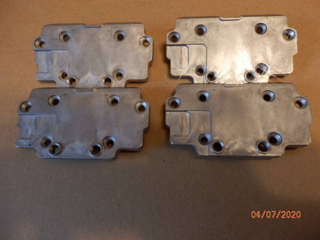

Ok...the Promax center carb metering block is mainly for hotter than stock cams. It does a much better job, IMO, utilizing the various circuits for idle, part throttle, etc and damn! sure looks cool too.
The front carb does not need the angled idle mixture screws.

I am not using a 195* thermostat. I have been running a regular Stant 180* for years with no problem. I would use the rear base and the jettable plates from Promax. Use the stock metering block for the center carb and see what happens.

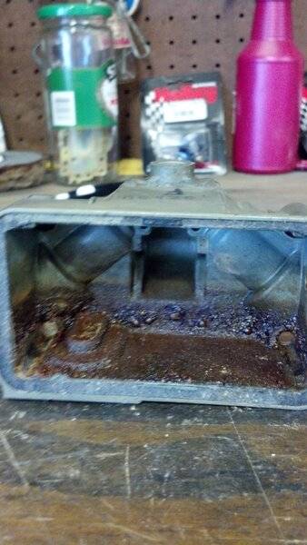

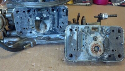

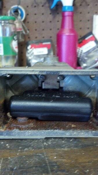

I have been helping a friend get a six pack setup to run right. The units are the new carbs, and ran great until it sat four years, we rebuilt the carbs, which was badly needed, But we still have an intermittent backfire out the passenger side tail pipe. one plug was sooted badly during our last effort. Also, the engine was modified around 2013, with a dyno sheet showing 472 HP at 5,000. After closely checking TDC on #1, it looks like it is 15 BTDC static. we are presently running the mopar electronic system, new out of the box.
any suggestions?
Rear base plate is a no brainer,bought mine 20 + years ago when they were $75.On the metering plate you can get them here for 1/3 the cost of Promax.
https://www.atminnovation.com

The outboard carbs idle mixture screws are VERY FRAGILE I've read several times, and require far less turning than the center metering block mixture screws do.
any suggestions?

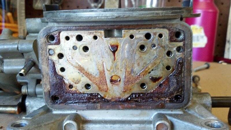

This is what happens when you let gas sit in the carbs for 15 years.
2539448D-D665-4A7F-A949-8774EE410A34.jpeg C81D5CAF-FB58-490C-9A4A-B2D3B893EBD6.jpeg 9D27127E-E391-4578-BA05-2383D7A194FD.jpeg F12D15B6-49E9-4595-A46B-47F015035147.jpeg
yes, they looked a bit like that. I TOLD him do not wrap that engine up! he did anyway.
We are getting there, but not there yet!
