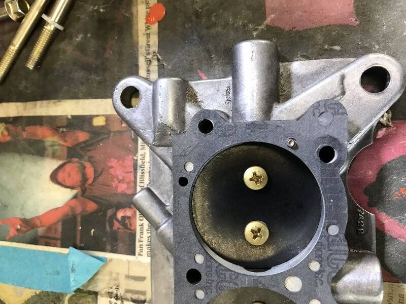

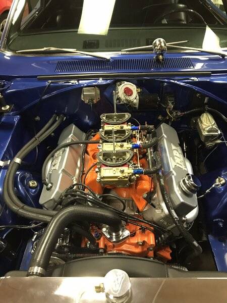

If you "messed up" that process, I would destroy it. That's another reason why I got the Promax jetable outboard carb plates.Complete failure with the drilled end carb plates., missing above 4000 in 2nd & 3rd. Magnifying glass revealed swirl marks from the drill/pin vise.

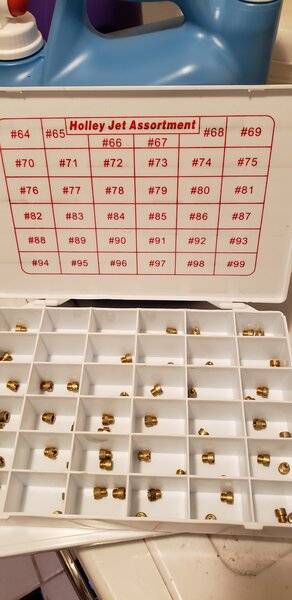

I just got these so I have 4 of each size of jets, plus some others for the center carb:
The Promax center carb metering block is fantastic too. Angled rear carb idle mixture screws were a given, as I too found a "workaround" but that was so cheesy and inaccurate...

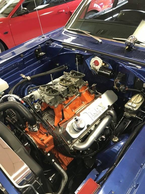

Unless I have around $5K fall in my lap around the time I'm scraping together every dollar I can to finish my stroker build, I'm going to have to start out with my Promax modded Holley carbs on this Weiand intake, so maximum flexibility and ease of tuning is going to be critically important.
Even now, with the 292°/.509 cam, headers, etc and using my Innovate Motorsports dual wideband O2 system I have benefited from the Promax mods.

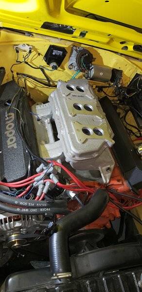

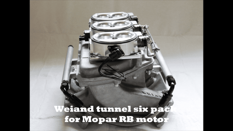

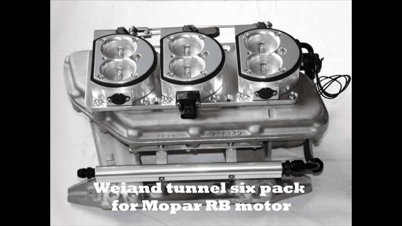

Now if I happen to have the coin, I'll have what I consider the ULTIMATE 3x2 induction system, from F&B:
