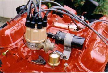

the vacuum canister should be pointing about like in the picture below for the correct timing...just ballpark figure until he gets it running, then get the timing gun out...

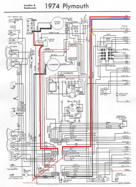

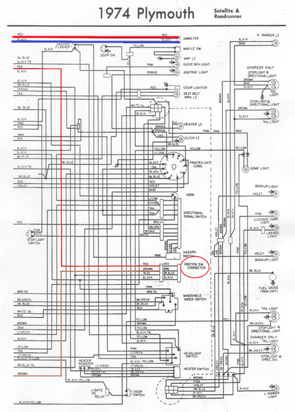

and while were waiting on charge lol :grin:....I made these earlier to explain the routing of the wiring in question...i figure someone searching may find these useful :)
The explanation of these highlighted diagrams is in post #99
