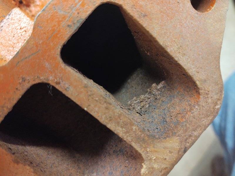

.... because this is what you want hanging over your intake valve...
Please people. ..look your factory castings over real well before bolting them on. You don't want this breaking off and going through your engine. I see this all the time, especially on intake manifolds.
You can clean that up when removing all the rust scale on a part that was stored in wet area.
