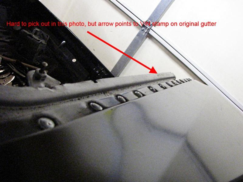

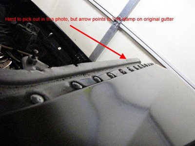

??? So you've replaced the rears, now the original vin seq # is long gone. Do you re-stamp it in there? not sure if that's legal but hey what if you sell it and it ends up back here with the buyer asking hey how do I know this car was not a stolen clone? lmao but seriously did you even consider it?

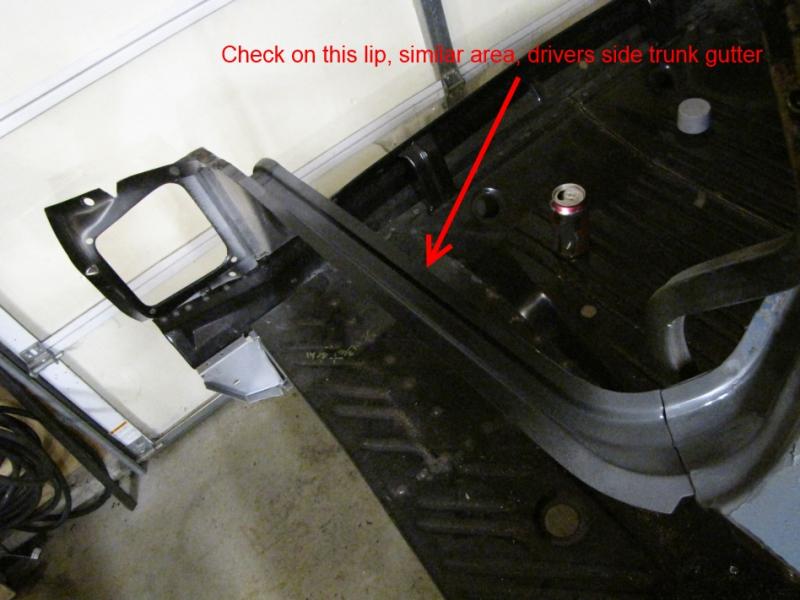

My last 6 of the VIN are 223367. Now that I found the right part of the trunk, it matches...or at least I think it does.
Definitely the 22..maybe a three and the other 3 is unreadable. Could be anything. The 6 is almost unreadable but I can see how it would be a 6 and the 7 is good. So I'm guessing with everything else lining up...its the right number.
