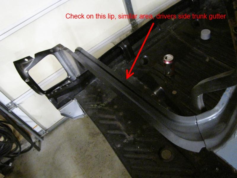

Stick your head under the trunk gutter. Check to see if there's imprints of numbers from the bottom side. Those numbers should be buried under the seal. P/N's are typically stamped in the drain valley of the trunk gutter. If you get a chance, take a pic.
The trunk rail #s are under the seal. the quater panel #s are in the gutter. The factory replacement quarters included the trunk rail & gutter. Like mentioned before, climb in the trunk and look up under the rail and see if it's there. If not start looking for evidence of a replacement panel.

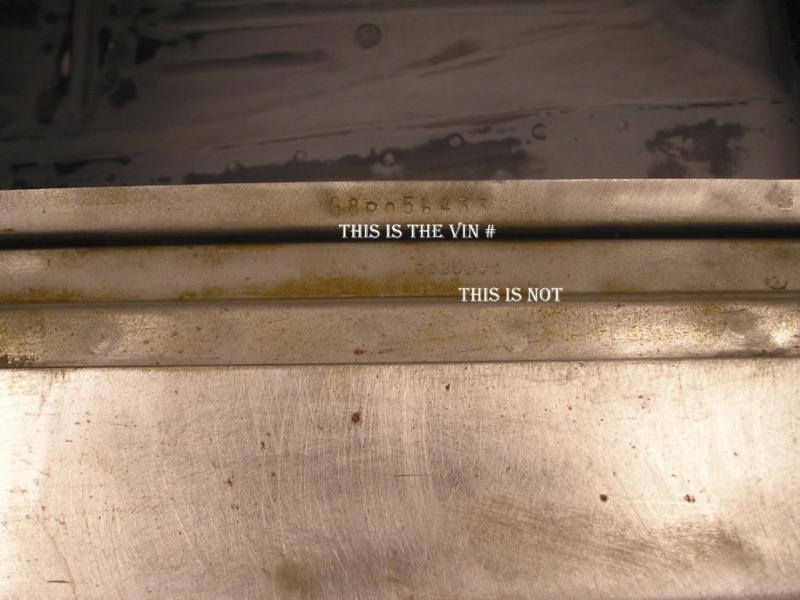

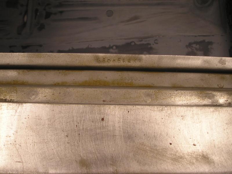

This is a '68 but should suffice.
