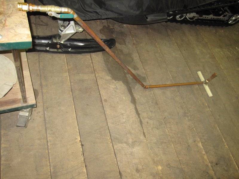

I soldered this tool up probably 20-25 years ago. Living in MI as I do I wanted to wash the salt off my truck and trailer. Discharge nozzle is a short pipe nipple I squeezed down in my press with a piece of sheet metal inside to give me a slit to spray the water. I just slide it around on the floor to use.

Seems like the catch 22 here would be the high-pressure water jet and its unique angle might unfortunately drive salty water into places/seams it would never get on its own in normal conditions and then become trapped for eternity, causing over time worse damage?

About as many years ago I tried something like this. Instead of the pressed end , I drilled several small holes facing up on a six foot copper pipe. Idea was to set it on the ground and drive back and forth over it. Turned out to be a bad design. The water didn’t come out with much force.
