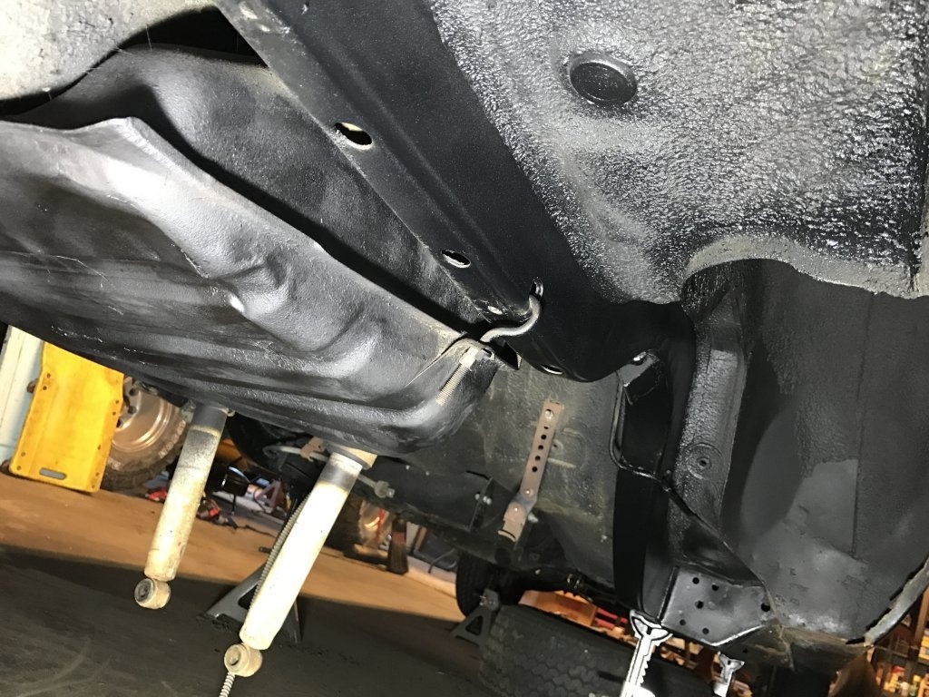

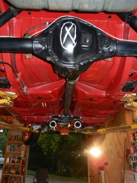

Here's a pic of the progress I've made in mine, cleaned the undercoating then soraued it with chassis black. I'll snap more pics when I get back in the garage.

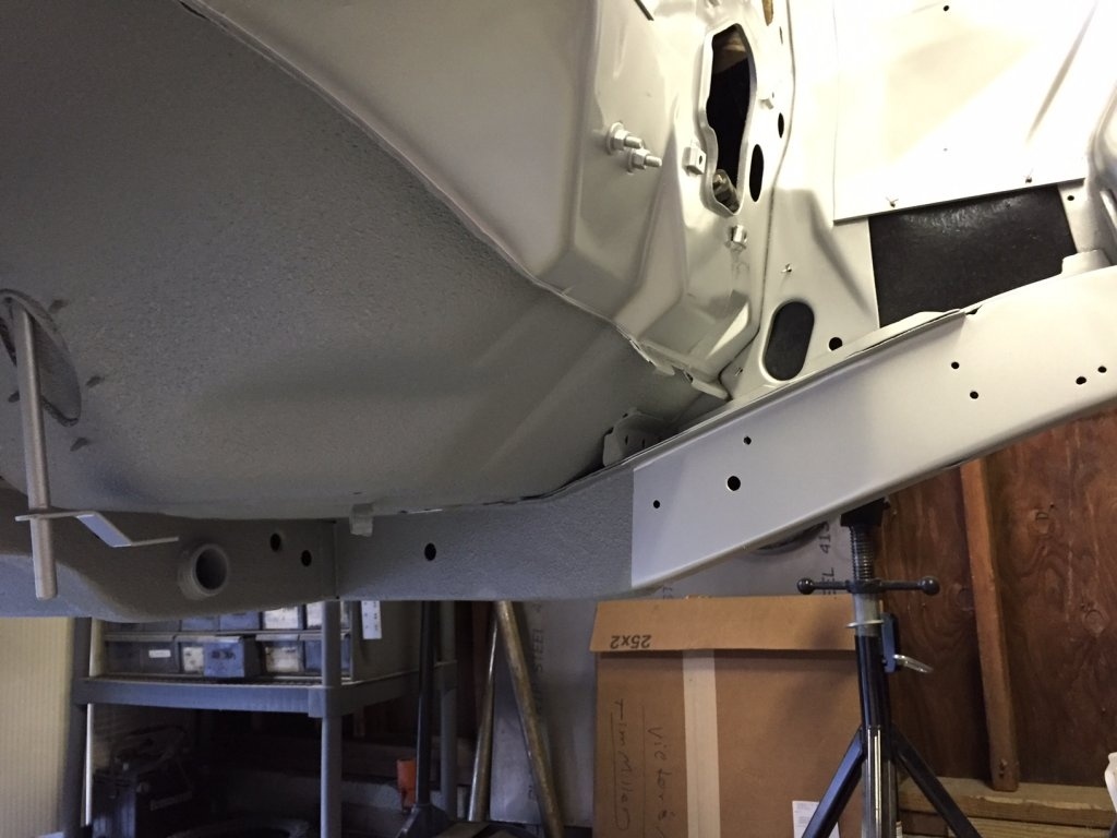

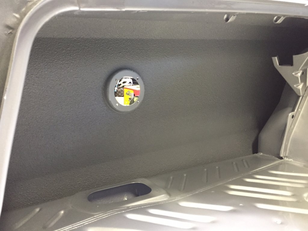

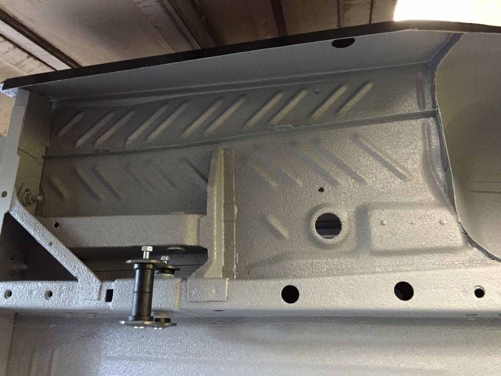

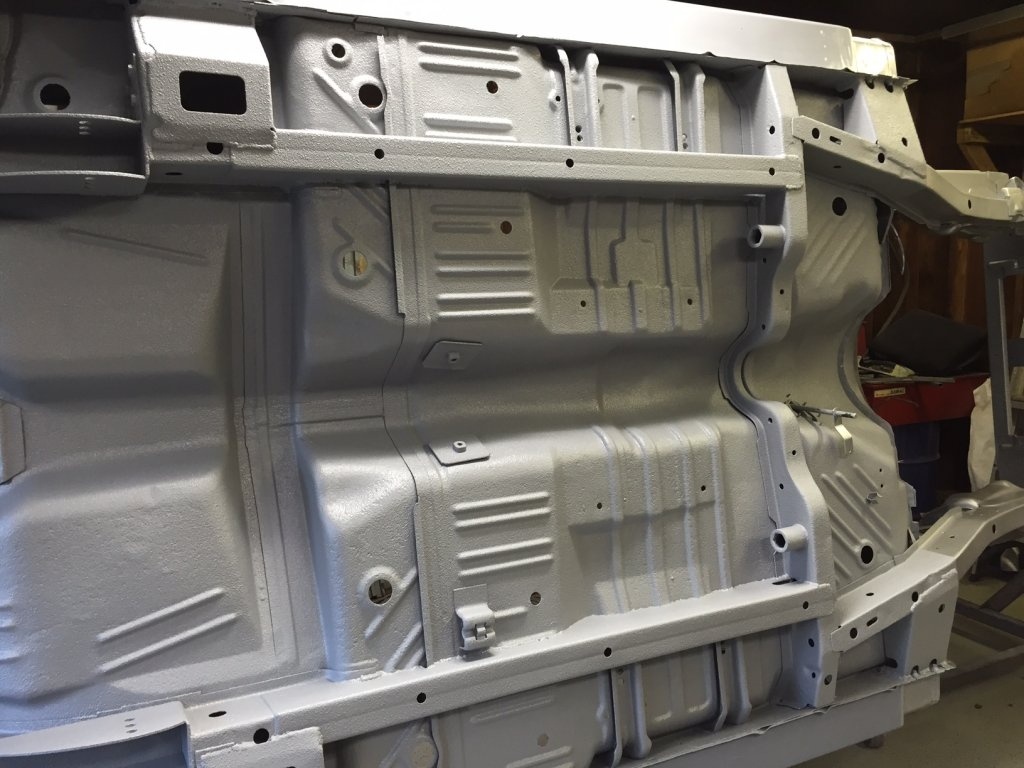

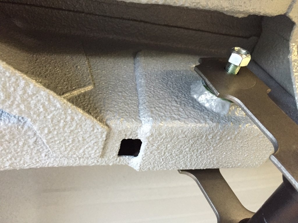

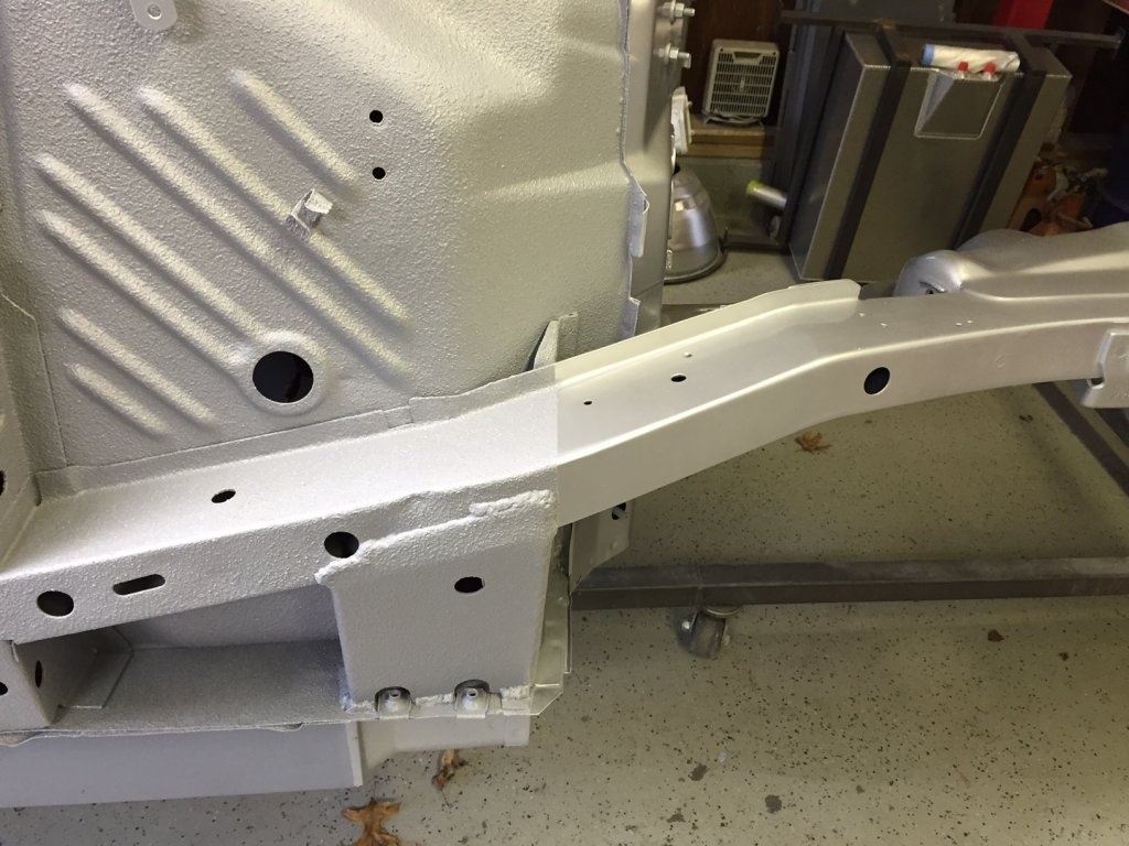

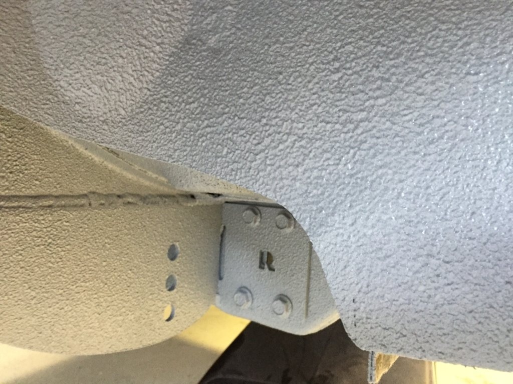

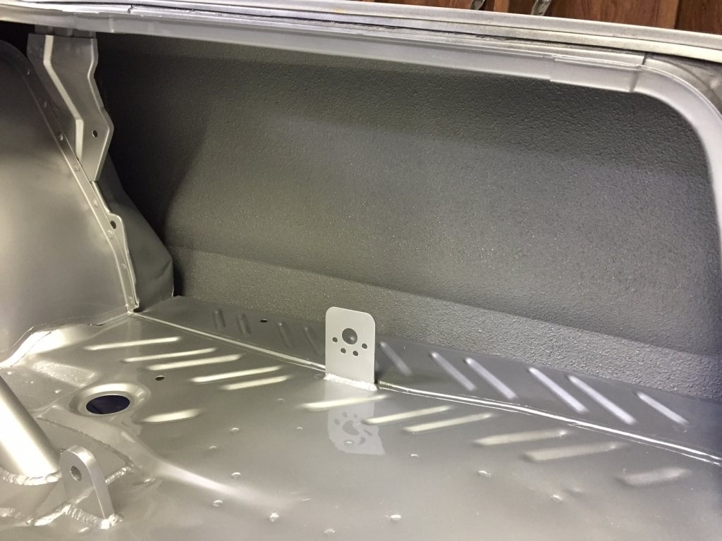

I used Color matched raptor liner. Mine is Viper silver (you add 10% base coat per bottle) Looks good and hides some imperfections but it is forever.
IMG_1125.JPG IMG_1126.JPG IMG_1127.JPG IMG_1128.JPG IMG_1129.JPG IMG_1130.JPG IMG_1131.JPG IMG_1132.JPG IMG_1133.JPG IMG_1134.JPG
I thought about buying the tintable kit but it looked more baby blue than I wanted...can you use any brand basecoat?
The Raptor kits come with a schutz gun made for thier containers PRDN

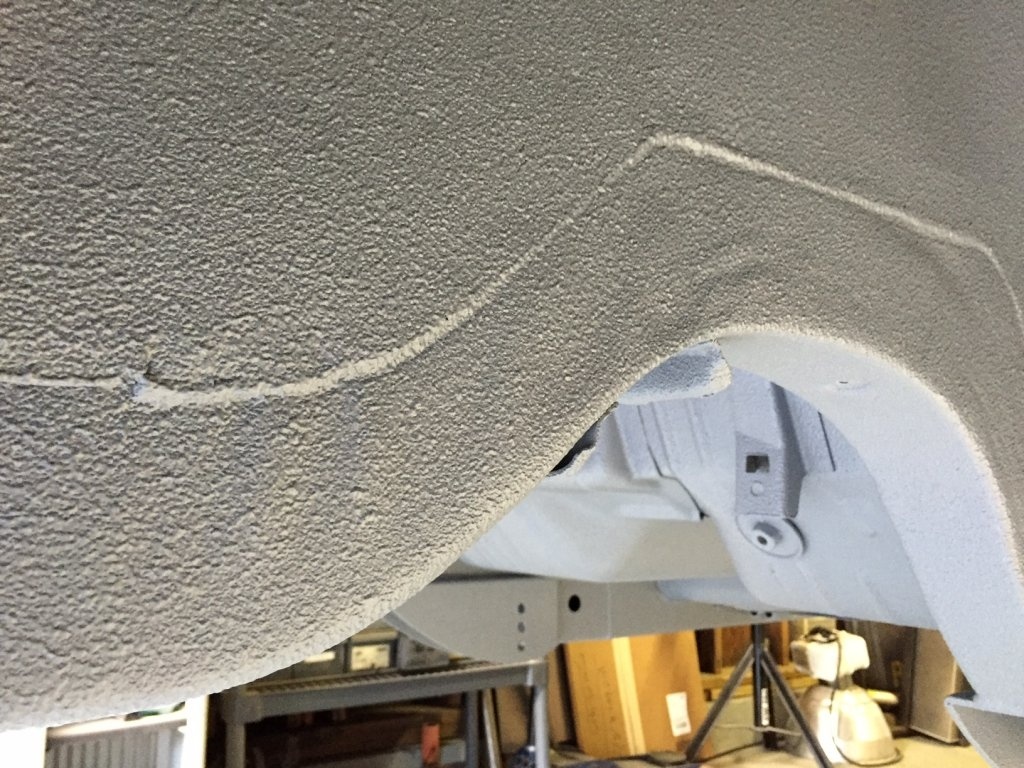

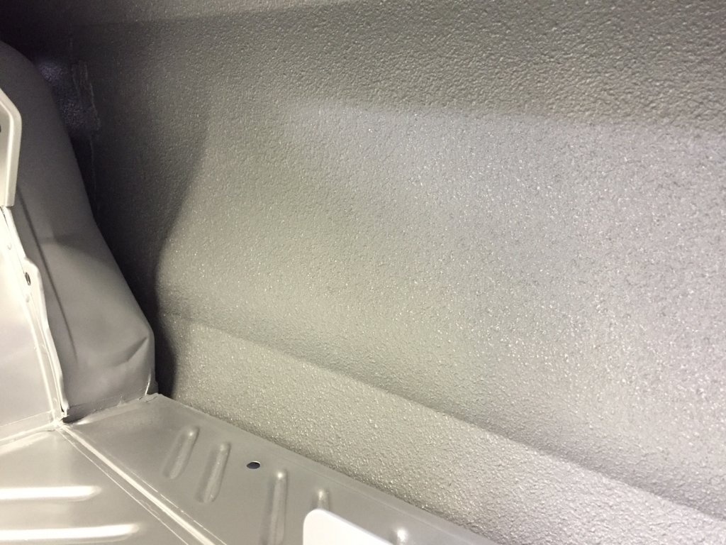

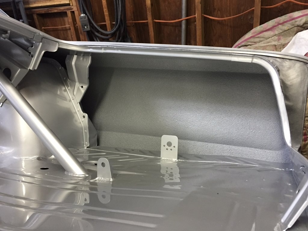

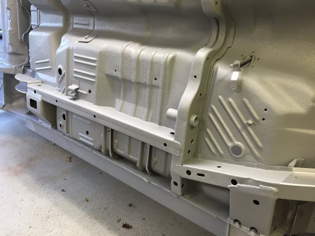

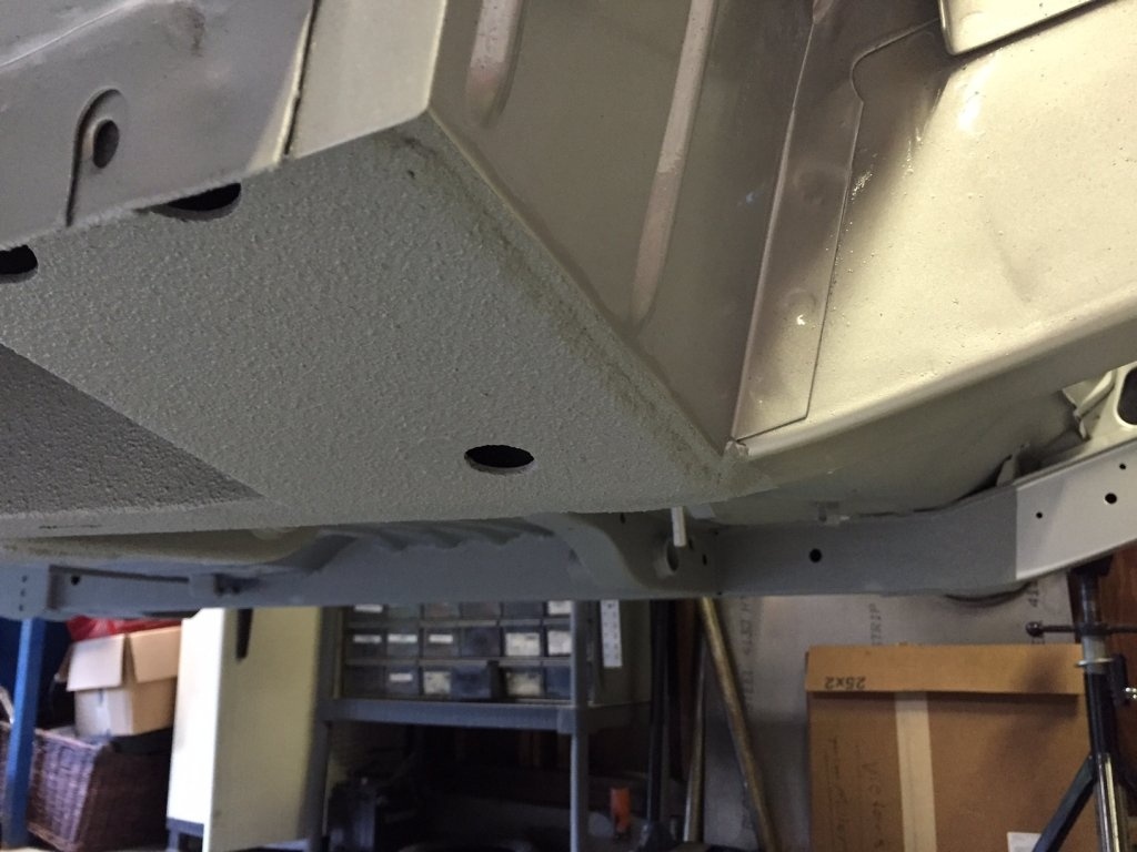

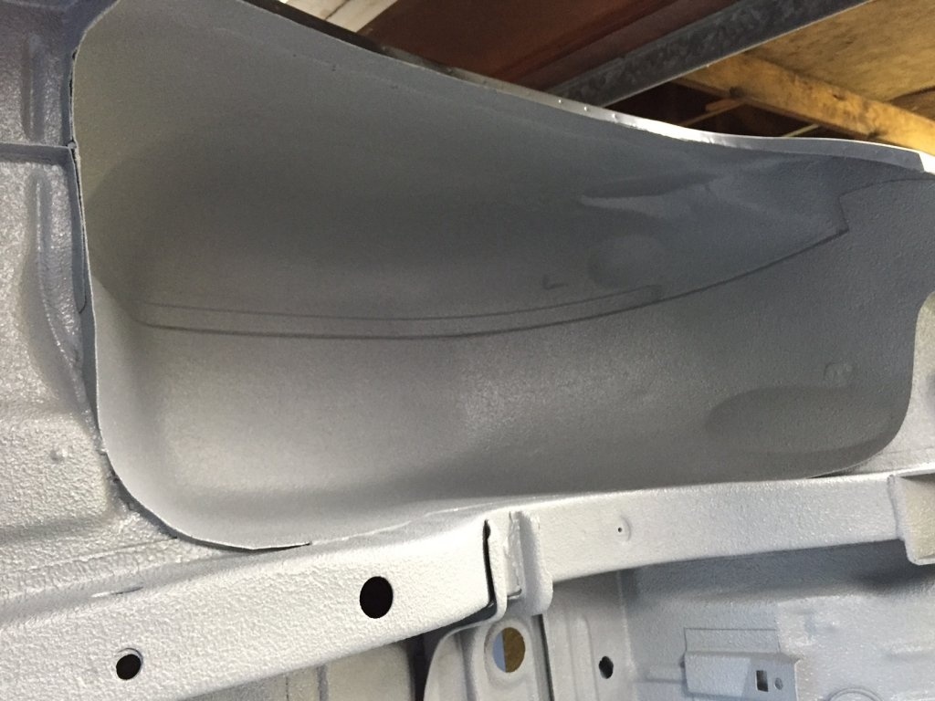

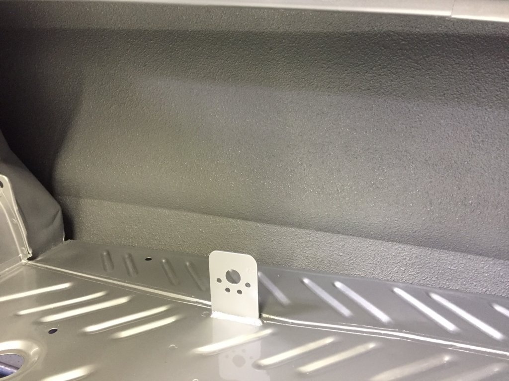

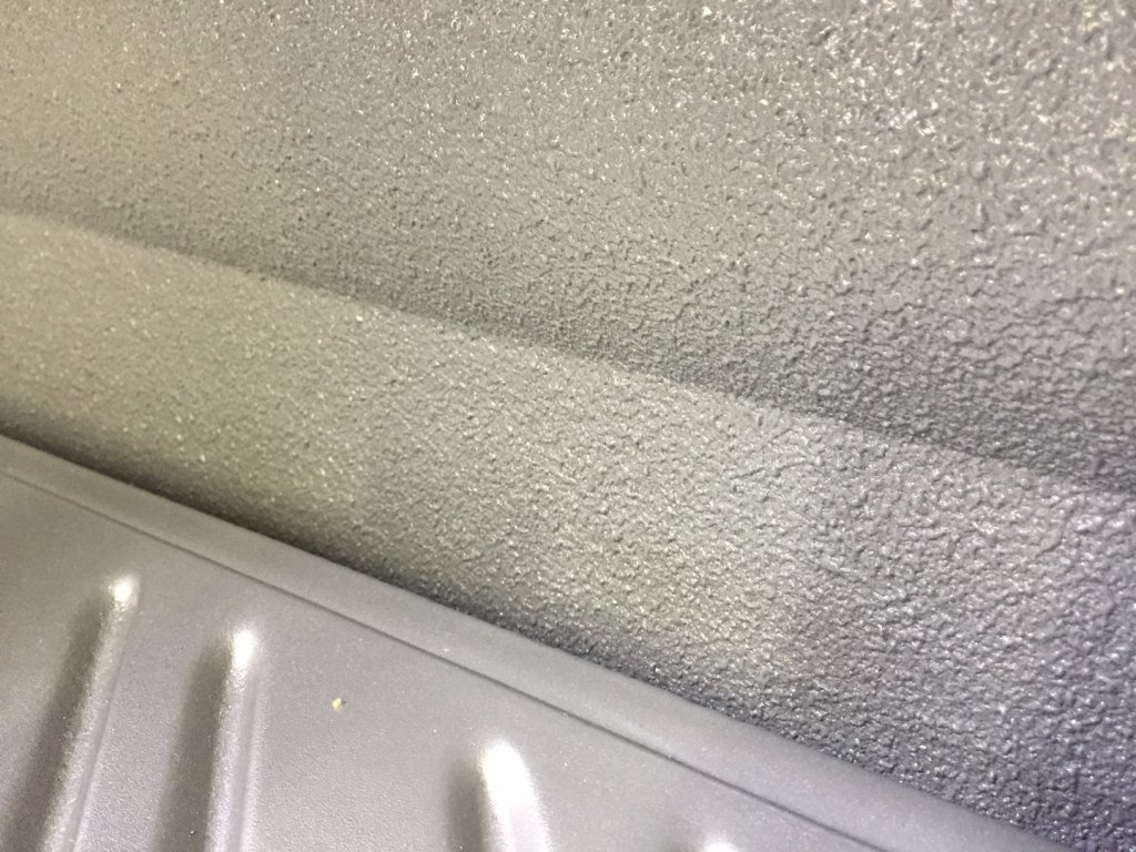

I think it works with any base coat as long as its solvent based. I used PPG Deltron. 1 recommendation I have is spray a coat or two of base on the metal under the tinted Raptor liner and it will match the base color more closely. I sprayed silver tinted Raptor over Gray epoxy and it did take on a gray undertone. I did sprayed silver base on the inside of the quarter panels and it's definitely more silver. Here a couple Pics of the inner quarters with silver base under Raptor for comparison. And by the way if you plan on going this route you'll need about 6 bottles for two good coats.

Awesome! Thanks for the tips 2Quick! That would be close enough to my liking!!!
Was that 6 bottles for underside and inside the trunk? I had calculated 4 should do the undercarriage fine (not spraying it inside the trunk), would you say that's enough for 2 coats or should I get 2 more bottles?
