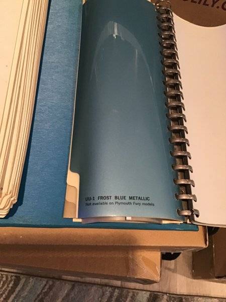

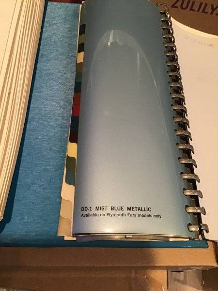

Looks like DD1 mist blue poly to me.
You need to get a 68 chip chart and put it side by side with your color.
Online is hard to judge , 68 has a few light blue belvedere colors available.

agree, the online color charts have me going in circles.
DD-1? Or maybe that Hawaiian blue 22-1?

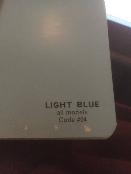

Hawaiian blue looks close. Kinda looks like 1969 Dodge Sportsman ”Light Blue” when I put this swatch up to your picture on the screen. Anything is possible with Ma Mopar.

I agree that the 69 light blue is a real close match from your pic. Thanks for sharing those. There's a recommendation to look under the package tray, sounds like a great idea.

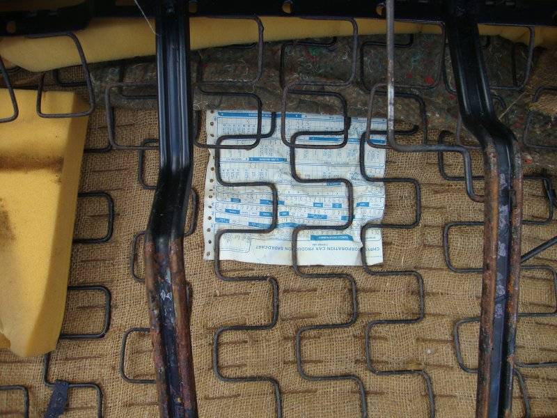

Fender tag. VIN tag is on the dash. But you are correct. Paint code would be on the fender tag. Have you found a broadcast sheet perhaps? Paint code would be on there also. Located in the springs underneath rear seat usually.
Example...
