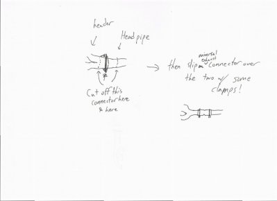

So i have located the leak... it's at the end of the header where it connects to the pipe (somehow it got bent real good)... and I have an idea to fix it...

If the exhaust piping is in good shape, you could probably carefully weld that up. A bandage will only last so long. :thumbsup:

Well I'm gonna try and put in some new gaskets and see if that helps. If not, then I'll consider welding it... It's just that the only type of welding I'm good at is oxy-acetylene. And I don't have any oxy-acetylene equipment, because I've been practicing at school... and I just graduated yesterday!
