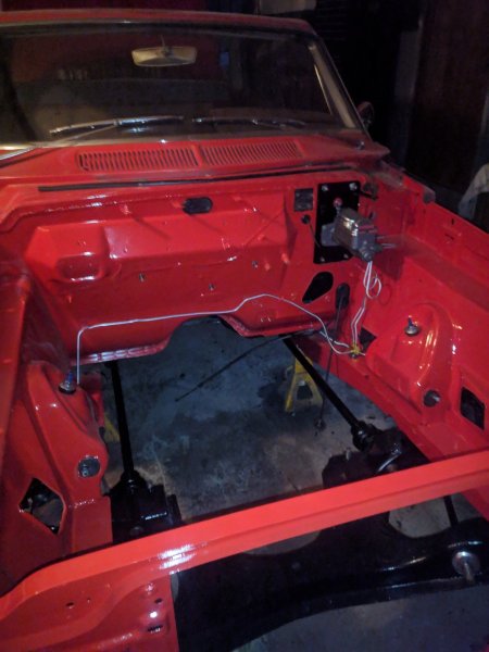

Honestly, i went with the piratejacks kit on my '62.. it was the least expensive and could not ask for something to bolt on easier.. (although i did put the calipers to the front instead of rear due to the lines being too long, not a big deal)
This is the master cylinder i used.. it bolted right upto the stock single pot holes on the firewall (there is a little gap on the top of the Mc where that dip is.. i filled it with silicone and smoothed it.. was a tiny spot, just letting you know..
Master Cyl..
I also got a brake line kit from inline tube which all went right in place without issue.. and a new distribution block which was like $25
P.S. inline has a line kit made specifically for early b-body single line to dual line conversions...
Not cheap.. BUT it's nice to know you won't blow a old line..
All in it's not super cheap but it's all new and bolts right up..
This is the dist block i got..

I believe the brakes will bolt on... MIGHT need different upper ball joints for the knuckles though.. or there is a tapered spacer that can go in there..
Was just trying to give you a list of parts, when i did mine i had to figure it all out as i went, was a pain
