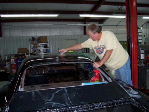

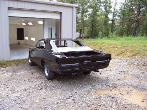

The first pic is the charger fresh out of the booth.
The second is of me wet sanding the entire freaking car with 1500 grit on a da sander. I hate this part.
Anyway, the next step will be to go back over it with 3000 grit on a da sander. I hate that part too.
Next step is to buff the entire car with compound and then polish with polishing compound. And, I hate that part.

I've only managed to wet sand the roof, the plug and the tops of the panels today. I'll wet sand the sides of the doors and quarters in the morning and buff everything out tomorrow afternoon.

The body of this big 'ol boat is finally buffed and polished. I'm going to move it into storage in the front building for a couple of weeks while I get back on customer work. I'm still waiting on my hollow aluminum wing anyway. No sense painting and buffing the fiberglass wing at this point, just to take it off later.
