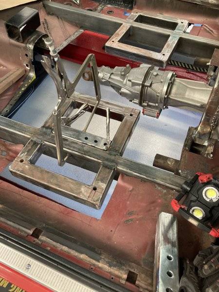

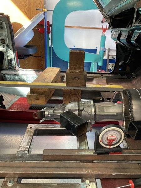

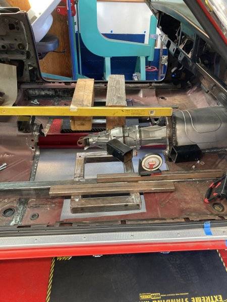

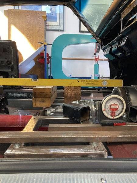

Today I did some mocking up of seat height, potential shifter dimensions, new sheet metal placement etc. The base of the level is sheet metal height. I was originally going to use a paddle shift unit but the company went away. Oh well. I got the dimensions for the shifter from Turbo Action. Theirs has a park/reverse lock out of sorts so that will be nice. Didn't realize just how tall that unit is from base to top of handle. Will keep looking at units. I don't like the ones from B&M/Hurst as they look cheap/cheezy to me plus the quality leaves something to be desired. Going by some of the dimensions in the Procar catalog, I set some wood on the frames to check height. My head brushes the headliner. That will be one of the things I'll be checking/measuring at the SEMA show when I'm there halloween week. The dimensions shown may be at the top of the bolster and not the sat in portion. Got to get that stuff figured out. Don't want to be in a high chair. When I was moving things around yesterday to get at the engine/trans, I found another TIG torch unit with the finger control that fits my unit. I swapped out the connector to the machine so maybe my next TIG job I can use the finger control. It's just on/off so I'll see how it does. Couldn't be any worse than me stretching out and using my toe on the pedal.

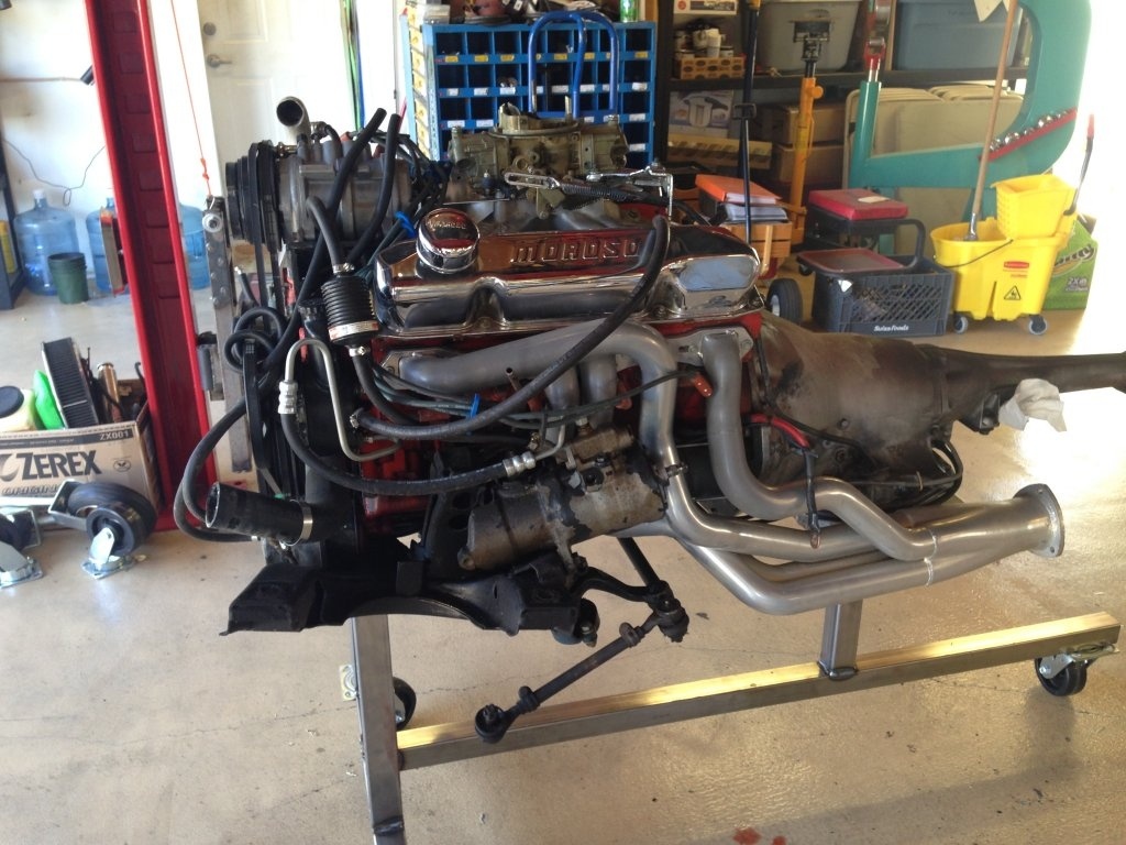

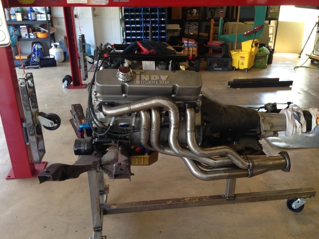

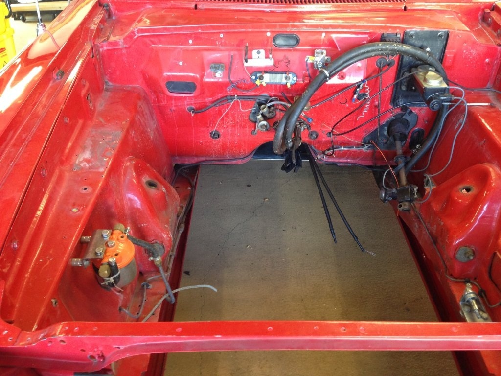

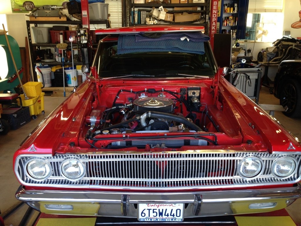

I've finally had time/funds to get after updating my 65 Coronet. This car is the one that was used for the cover of the old S A Design suspension and handling book from years back. My friend, Jeff Williams, that used to own it was friends with Larry Schreib and Larry Atherton of the publishing company. I bought it back in 08 after losing my 70 Challenger in the 07 fires that went through here. I did some basic upgrades on it when I first got it. New TTI 2" headers, 3" exhaust system, tires and other minor stuff. I started buying and stockpiling parts and assemblies for it knowing which direction I wanted to take it. I made Firm Feel happy, Indy Cylinder head for the new alloy bullet, Pro Trans for the 727, Gear Vendors OD, Dr Diff on the Strange Dana 60 plus 4 wheel disc brakes, ART [auto rust technicians] for structural pieces, Ron Francis for wiring, AEM on the efi brains, TTI for headers, Be Cool for the new radiator/fans unit, SD Concepts on the serpentine drive, Bergman Auto Craft for the Borgeson unit, Master Shift for paddle shifting, US Car Tool for spring relocation and mini tubs plus more to come. I already have the engine/trans out to start fitting things up. Figured this would be wise since I'm using a 70 k-frame. Pretty much cut and dried up front but in the trans extension housing area, because of the GV extension/adaptor, I will have to do some remodeling on the floor because its got almost as much girth as a 518 trans in that area. If I had gone straight 727 it would be close but no issues of hitting. I have found some old car damage as far as stress cracks in the rh frame rail where the k attatches and the passenger compartment floor. These along with excess hole will get welded up. The only holes on the firewall will be for the master cylinder, steering column and my planned old school NASCAR cowl induction. I have also spent some time working the k over with a bunch of reinforcing and added plug welds[ 100+ over the factory 30 or so]. Once I get things fitted up, I'll strip the engine compartment of paint/junk etc, do all the metal work then paint the area again after which I'll move to the middle for structural pieces then the back for its portion.

That thing is beautiful. The 65 grills are easily in my top 5 fav on any mopars. You got yourself a real gem there. Coronets just have a look to them that I cannot resist.
Thank you for the kind compliments. I'm very lucky the car is in great shape. Not a rust bucket, the trim is mostly great and there plus its not a bondo bucket.

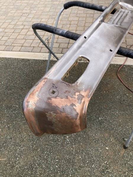

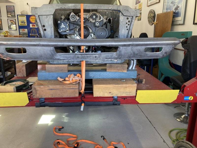

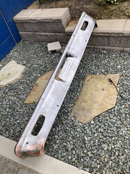

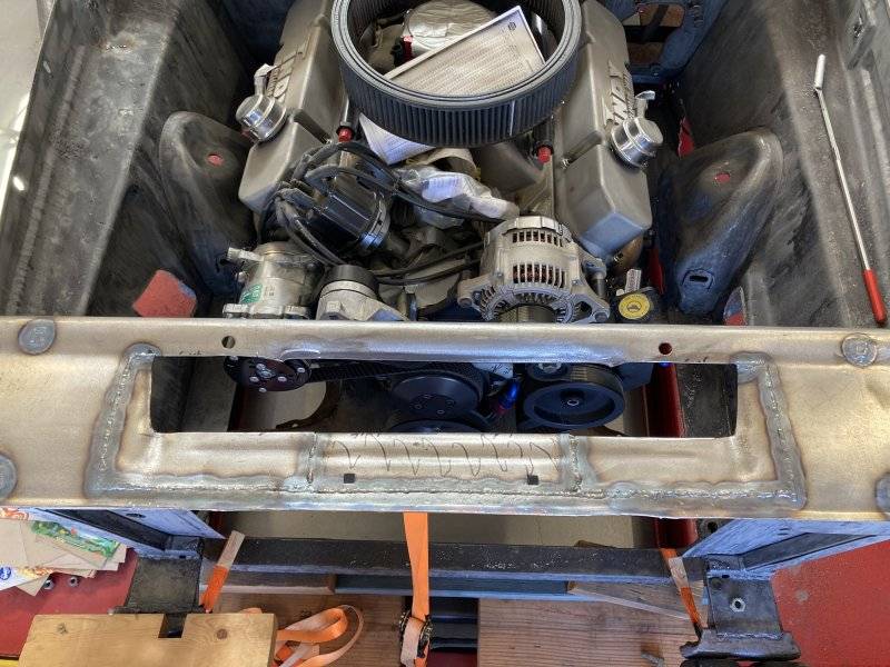

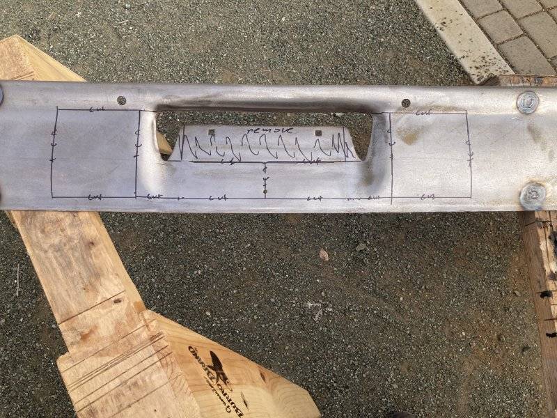

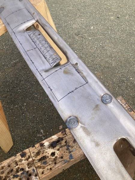

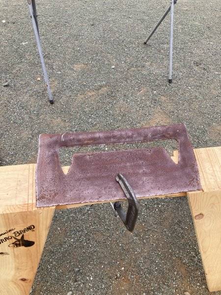

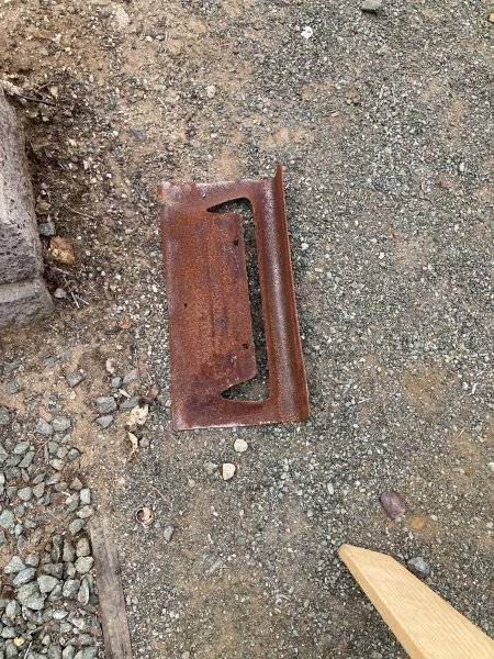

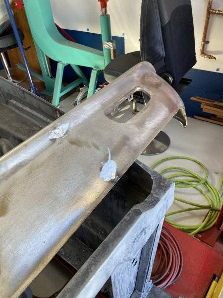

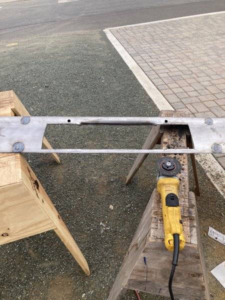

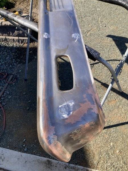

I changed directions today on the car. Since I need to clarify the seat dimensions, even though I have the Procar catalog, I figured it would be wise to not do the center piece of the trans tunnel right now. Just in case I have to unzip the seat mount frames I welded in which will affect the sheet metal etc. So... I started on the front bumper. I had it and the two donor pieces chemically stripped awhile back to remove the plating. Even though they were in the back of the garage, still got some rust on them. The donor pieces especially. Probably should have washed them down with something to neutralize the acid that may have been leftover from dipping. I buffed off most of the rust from the three pieces then put the shorties and the soon to be welded bolts in the cabinet to blast off the remaining rust. From there I started welding the bolts to the bumper. Will continue on the next work day.

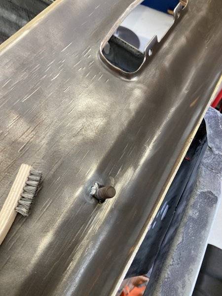

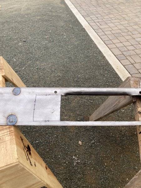

Had a little free time after my Monday morning duties. Got the heads of the tacked in bolts ground off. Tomorrow will weld the left over square to the bumper to finish the attachment. After that, measure and mark out my cut lines for the soon to be widened center opening.

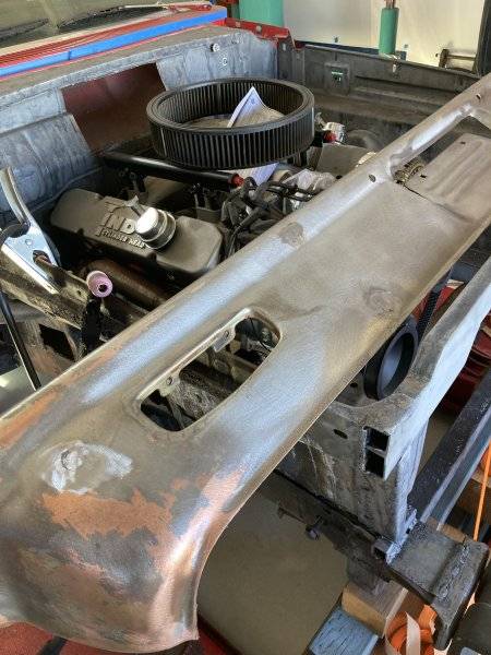

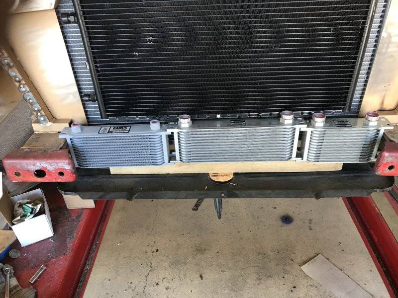

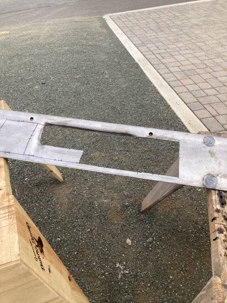

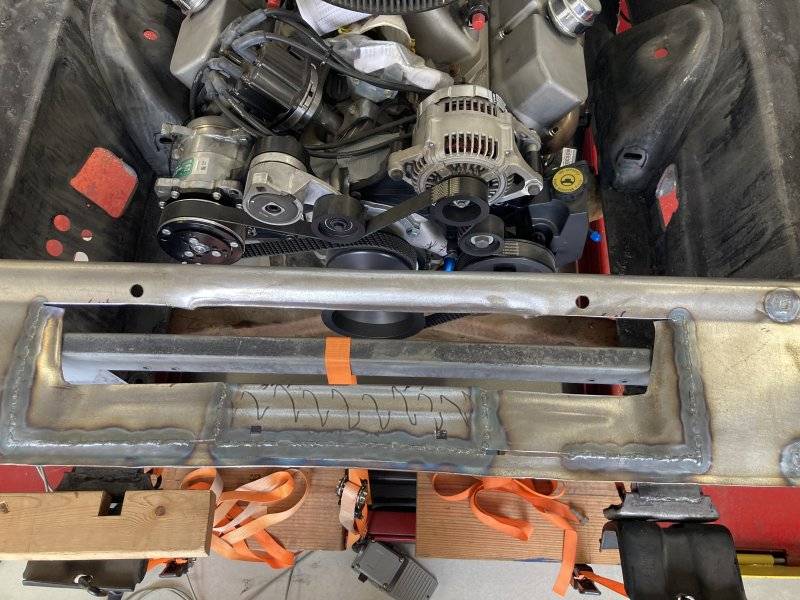

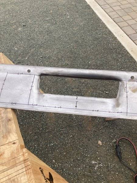

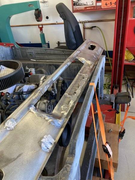

Today I marked out the cuts on the bumper and commenced making sparks/grit. From there, de-burred all of the pieces then started putting pieces together. I have the basic unit together now. Tomorrow I'll start fine tuning it. For those going WTF? the reason I did this is because my three oil coolers are behind that opening. With it being now widened, they will enjoy the extra airflow.

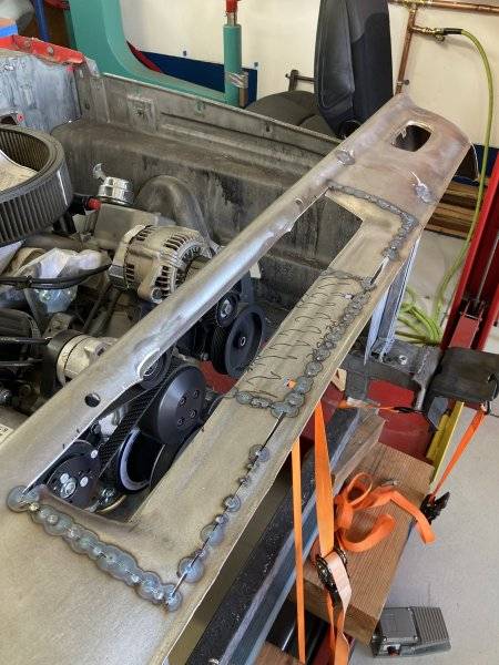

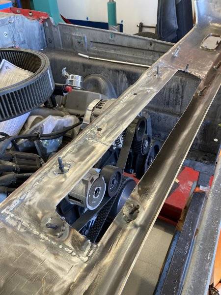

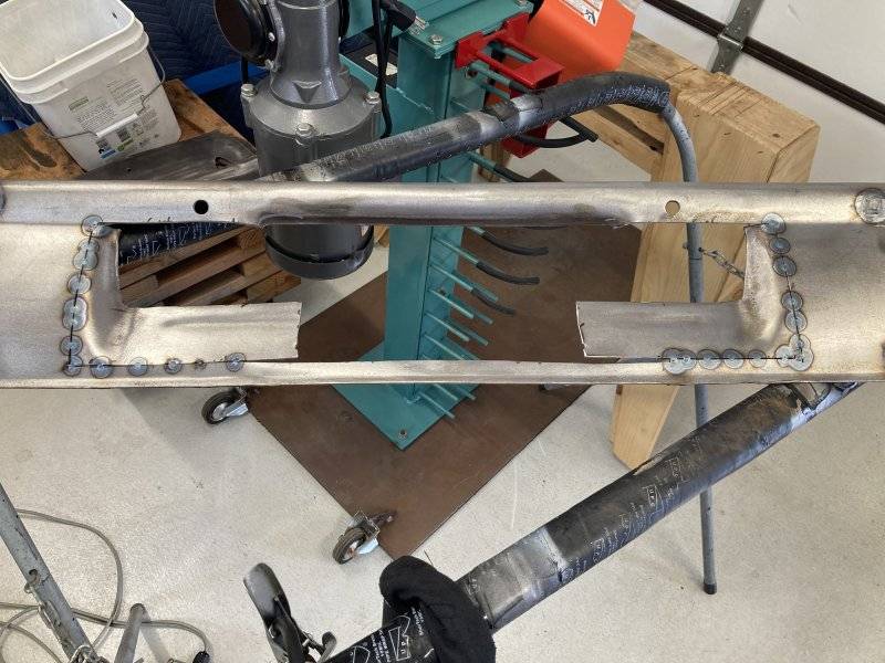

I was able to do the rest of the welding today plus a little hammer and dolly time. Next time out will be doing some weld grinding.

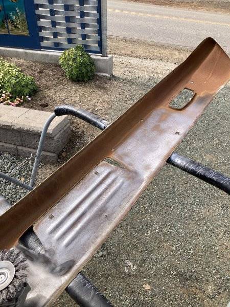

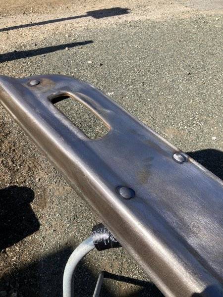

Got the welds ground down late yesterday. Today I trimmed up the two horizontal portions of the opening to even them up some. Took the wire wheel through the backside where I could get it in. After that, I welded on 6 elevator bolts to the backside of the opening. This will give me some anchor points later when I make up a mesh screen for road debris. I was going to spray it down with some Ospho but it's too breezy here right now. Maybe tomorrow. This will keep it protected until I'm ready to do some lead work on it. Metal Bondo!

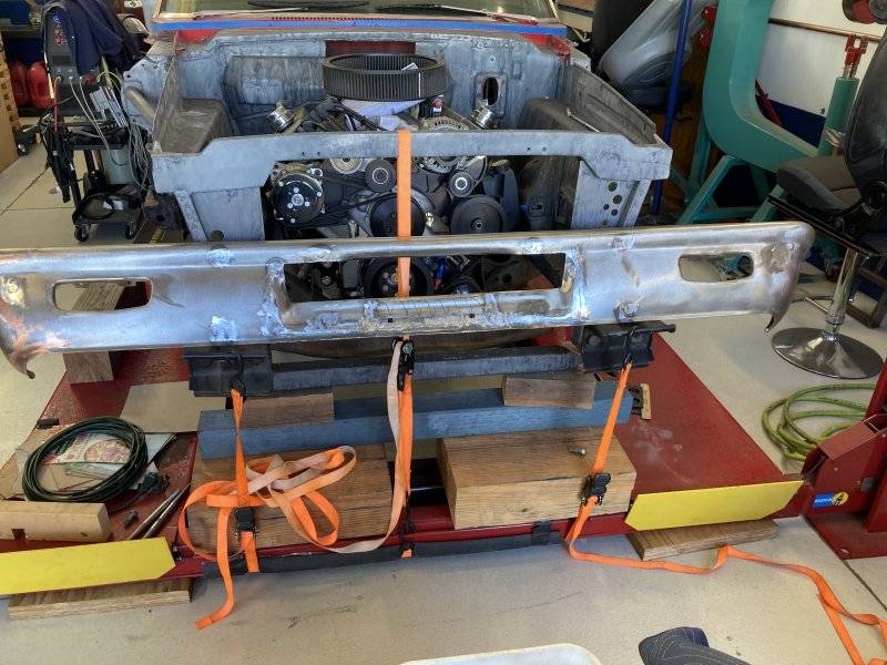

Yesterday was an easy day. Set the bumper in place before I put it back on the bench in the rear of the garage. After that, did some wire wheeling of a piece I made that goes between the lower tie bar and the stone shield. After I get back from the show, I need to hunt down some proper hose for my blast cabinet on the pressure and suction side of the gun. Pain to use right now.

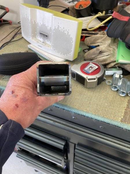

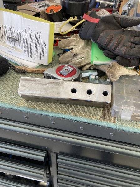

Back on the car today. One of the many questions I needed answers for from the SEMA show was where on the seats I'll be using was where does the crotch belt come through in the cushion. Now that I have that basic info I saw there was going to be a need for some structure to anchor the belt to. Made some measurements to cut some material. 2"x.120 wall square and some pieces of 1/2" id heavy wall tube. I decided to put 3 in per side just so I have some angle adjustments of the belt anchors. Welded up the units today and tomorrow I'll place them in the car. After those are in, I'll get back onto the sheetmetal for the floor.

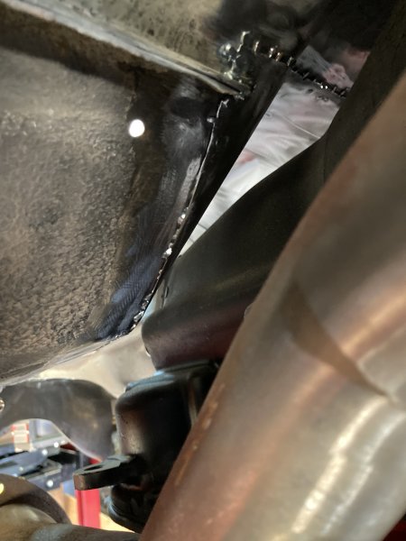

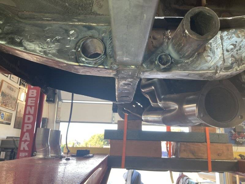

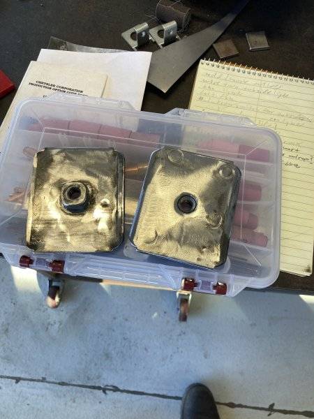

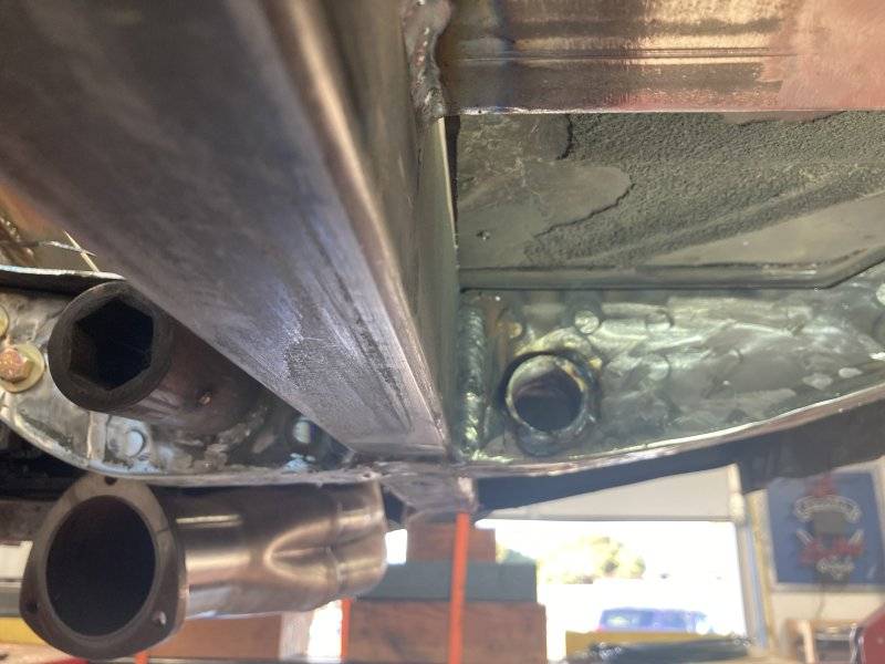

Got the crotch belt anchor units in. From there, I cut 3 holes though the t-bar crossmember for pass throughs. One each for battery cables, e-brake cable and fuel line. Battery will be on lh side outer of the SFC, e-brake is inner lh side next to the t-bar socket, rh outside of the SFC is for fuel line. Tomorrow I'll grind down the excess material/welds, finish welding what I couldn't get to and grind a little more.

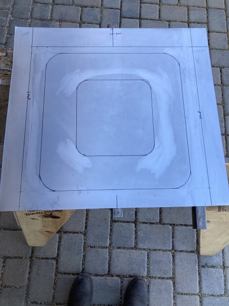

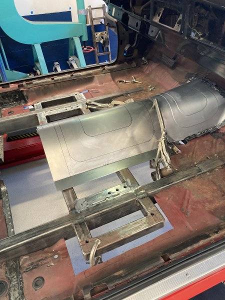

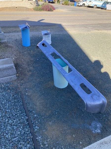

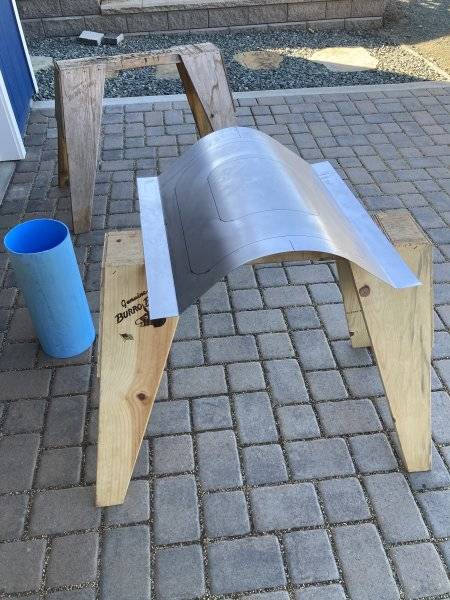

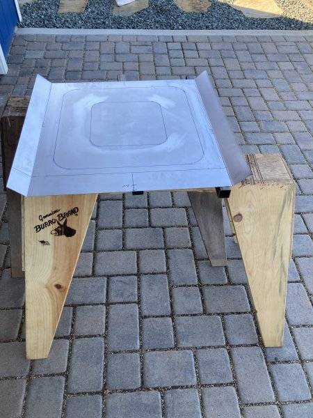

Today I laid out, cut, marked and did preliminary bends on the center portion of the trans tunnel. Monday I'll do some fine tuning/tweaking then bead rolling. Used the blue PVC for the first portion of the radius then used a 4" or so fence post across the street to pull it in a little more.
