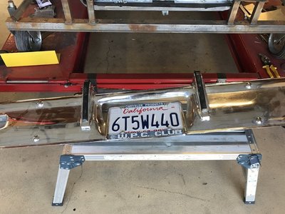

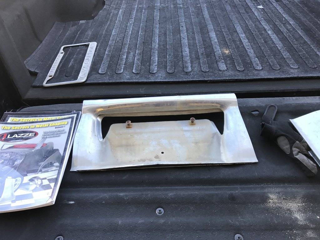

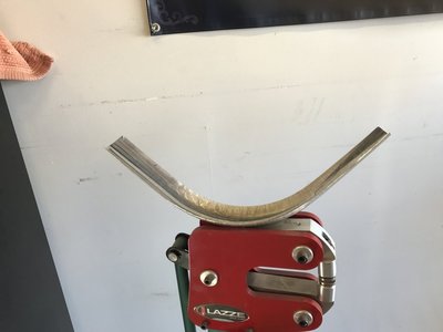

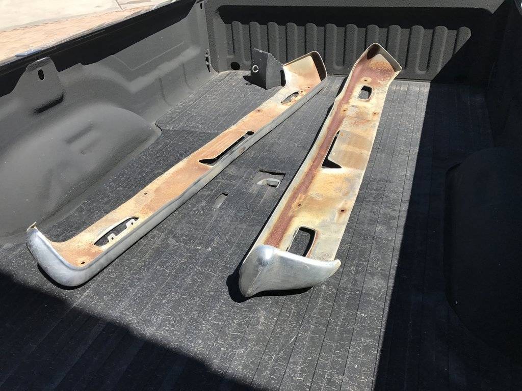

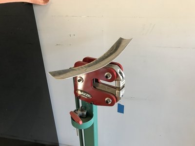

Met up with a guy yesterday that has an awesome collection of Mopars, wonder if he needs a new son. LOL! He has a nice stash of early B parts so I was able to get a couple of bumpers from him. Might be able to hook him up with my cast off pieces in further needs. Got them home and took my sawzall to them to harvest out the needed sections. Don't worry, I didn't hack up pristine units. One of them even had a license frame from the dealer in the town I grew up in and that my parents had bought the wagon and truck from in the 60's. Cool! After the hack fest I started forming up my air cleaner unit. For the basic shape going on my wheel then from there transferred to my shrinker/stretcher, shrink jaws in, and started getting it in a U to wrap around the spacer on my TB. This will be part of the plenum and from there I'll be heading towards the firewall. The filter I chose is for a 14 and newer Vette [yikes!] since on that cars application with a blower, I figured the airflow would be sufficient. I was looking at using a filter from my 04 Cummins or a like 95 truck 5.9 gas but that would require me to shorten/re-thread/re cut o-ring groove on the fuel rails. Going to work some more on that today after church. For the bumper, my plan is to widen out the license opening as far as possible, which is why I needed graft material, so that there is plenty of airflow to the oil coolers and a little extra to the radiator plus through the engine compartment. Trying to maximize airflow to keep things cool in there.

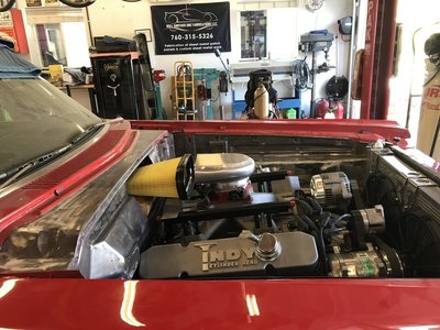

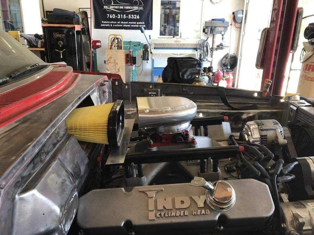

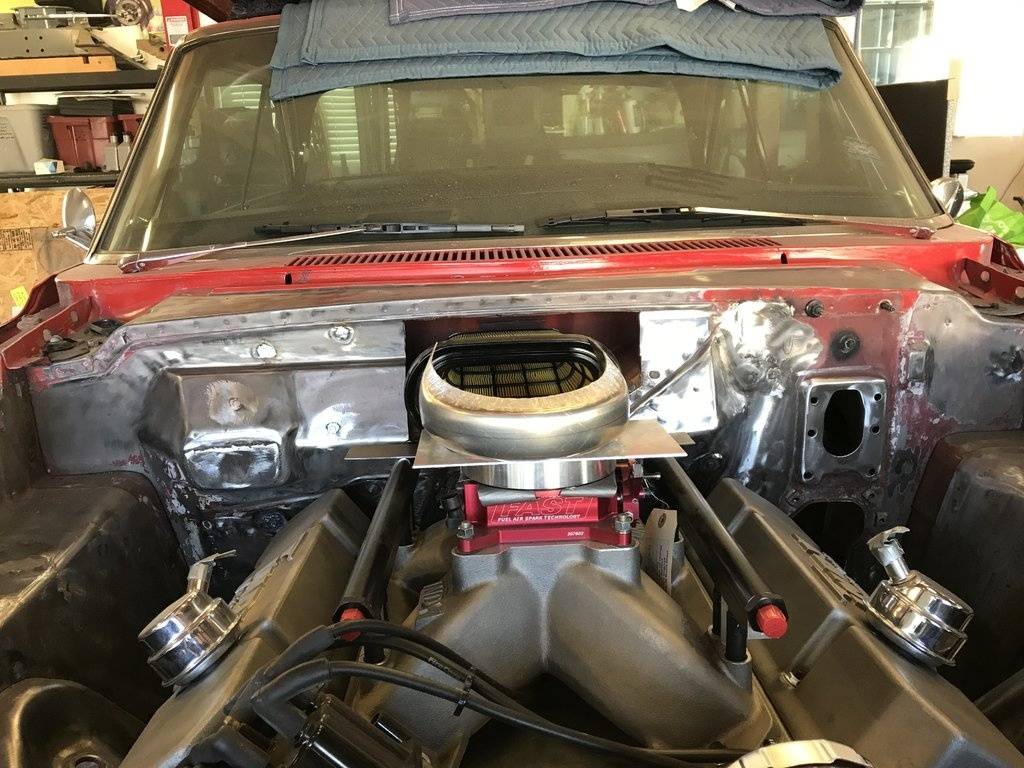

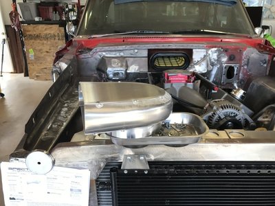

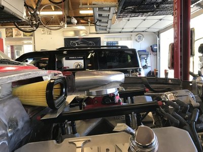

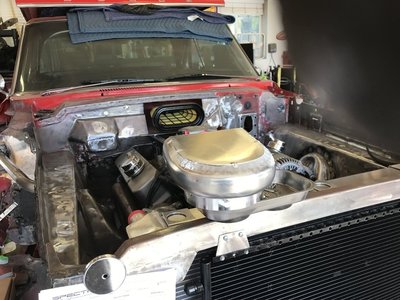

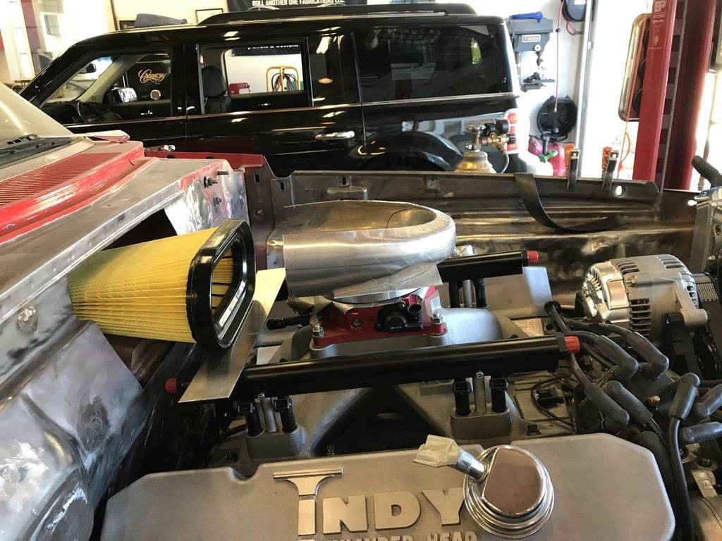

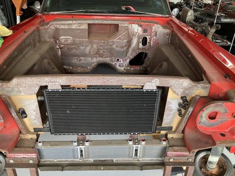

I worked on the plenum to TB unit today. Cut out the base filler and the top. I tacked it to the spacer then did a side look at it and figured I had better set the front sheet metal back on to make sure there was clearance to the hood. It just hits the inner brace so I need to shorten the spacer, drop the plenum down low in the front and should be good to go on that. For the filter box, it needs to be no more total height than where the filter base is now. I pulled out the radiator to give me a better view which worked out great. The upper tie bar portion of my fabbed core support is going to work fine. Will continue hitting it this week. Hope its cooler as its been 105+ and almost raining. No A/C where I work, just some fans to blow air around. I've been back on the 67 Camaro at work replacing the heater core which is a major project requiring removal of fender, hood, inner fender, grille, bumper, carpet, seats, center console etc. Friggin sweltering in the interior with no air flow. When I get home, I've had enough for the day so no work on mine. supposed to be cooler this coming week.

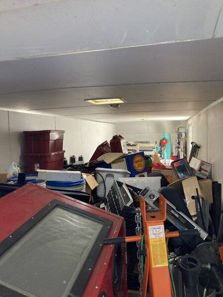

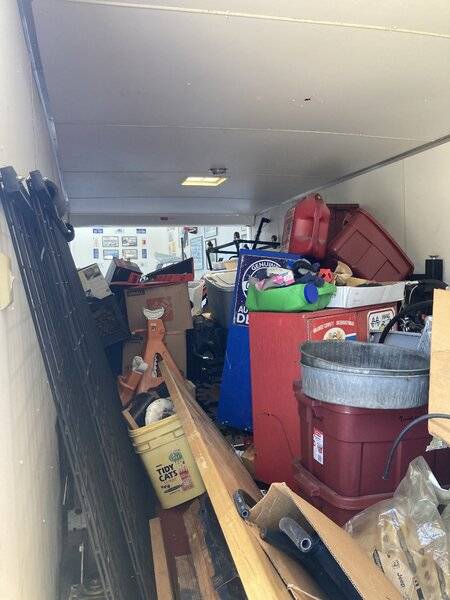

This is what the inside of my trailer looks like currently. Lots of stuff!

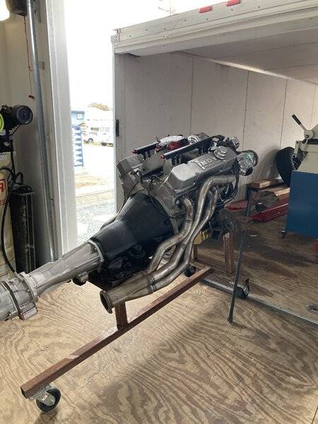

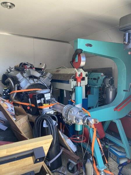

Been making some progress emptying my trailer this week, should have it wrapped up today. The engine/trans is back on concrete.

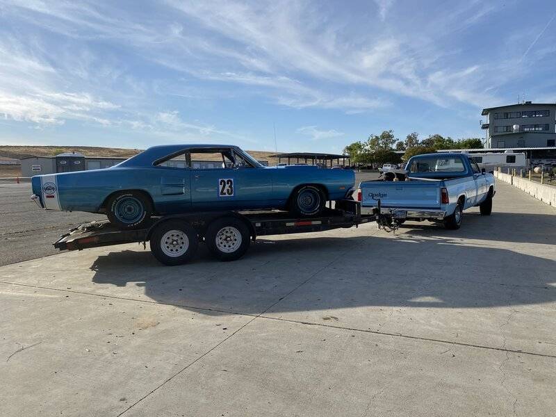

I unfortunately understand the difficulty of managing multiple projects along with trying to cordinate a move. This year I just finished restoring my 77' D-150, which I dissassembled back in 2008. I stalled on it enough to where I thought I was going to have to scrap this old truck? Luckily I had a an opportunity come up that helped me finance the project and now its done. Along with getting the money to finish it, I set a deadline to finish the truck. That really got things moving too. I'm really hoping to get a track day scheduled for next year, just waiting on the 2022 schedule to be released at https://www.ongridtrack.com/. Maybe we can pick a track day and I'll meet you there. A deadline so to speak.
Good luck with the build, I'll be following along.
(here's a pic of my D-150 pulling the Bee at ThunderHill for motivation)

A Dodge pulling a Dodge! I have an 04 Cummins dually as my daily driver. I'm hoping to get some work started soon as I do have the time, its just the lack of funds. I'm checking pricing/sources to get my front bumper stripped/de-chromed so I can do my mods to it. The engine bay needs to get sandblasted which is easy and won't cost much if I DIY. I'm not sure when I can make big progress on it but just have to wait. Do you get down to Buttonwillow? Let me know if you do and I'll head over. I did see the schedule for the organization you run with. I will get over there sometime to check out the happenings. One of my main holdups is the drama/CF of the garage build here. Unit is done but I have work to do on old one so the permit can be signed off. From there I have a bathroom to redo in the house, found the source of a leak and black mold. Its been gutted for over 2 years. But other than that, life is good.Lessons in patience to me

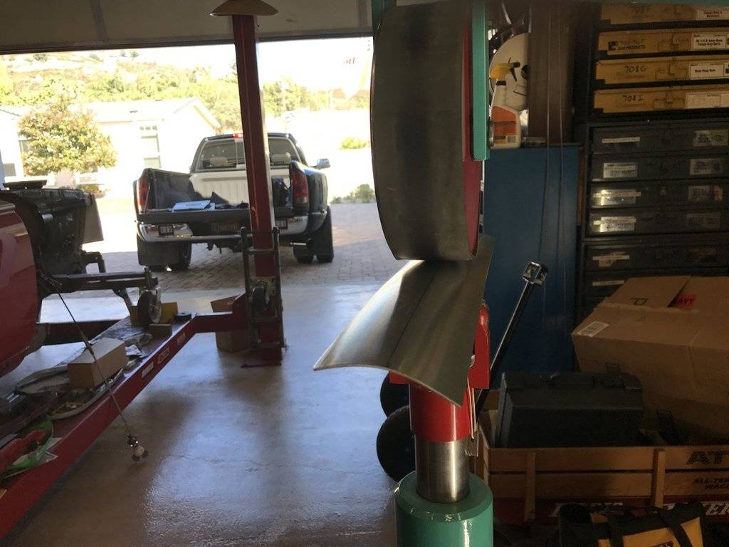

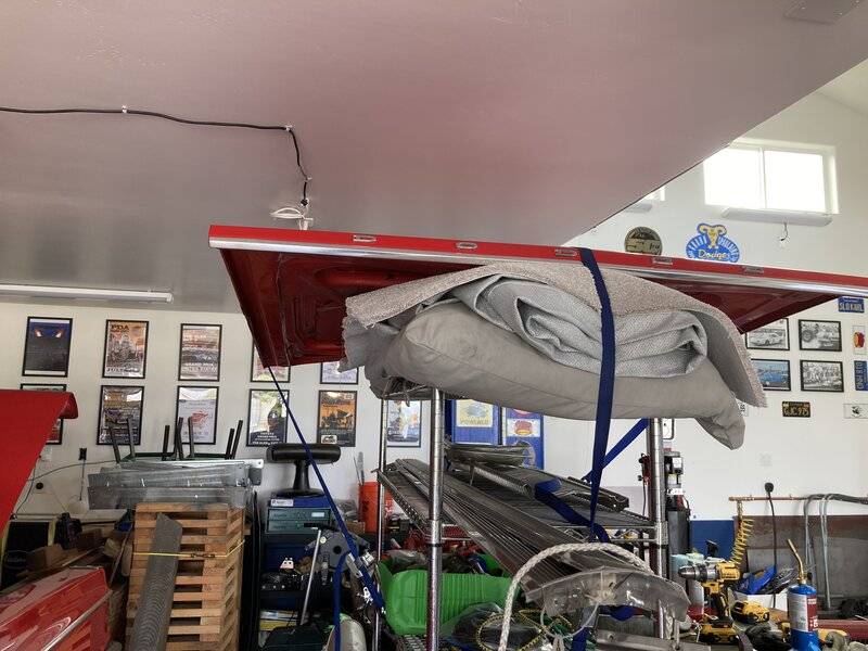

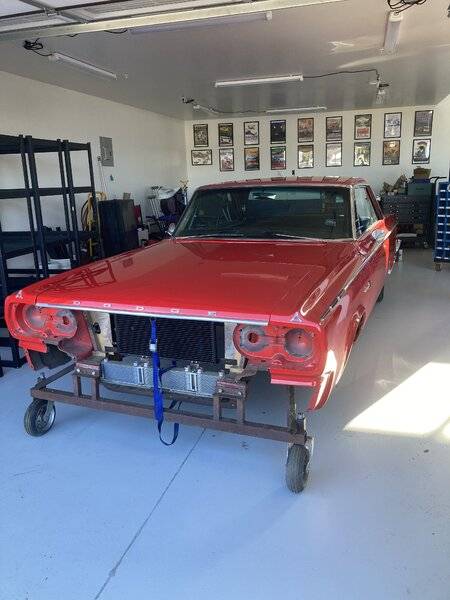

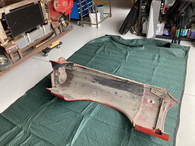

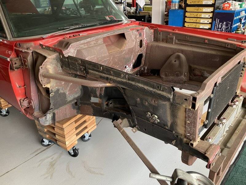

I'm getting back on the car project! I moved some stuff around in the garage, tossed some items that were not going to be used, shuffled more items around and freed up some shelf space. My neighbor helped me get the hood off so it could be set on a rolling rack. Its tall enough so that I don't have to duck. I picked up some new moving blankets from HF, they had a new size. 144x80. I was able to set the fenders on them and wrap the blanket around. Put some bunji cords around them to keep the blankets on. I recycled some foam insulation packing that is used for keeping the frozen pet food frosty in the box from Darwin's. Layed a 3 panel strip on the wire racks, then put the fenders on those. I'll get the various heat exchangers off next. I need to get ahold of some of the plastic car bagging to cover the car when I get after the rust. For Christmas I received some dough, so I bought the SCT unit from Eastwood and two each carbide coated nylon bristle brushes and flap wheels. I'm going to use those for the bulk of rust removal and then blast whatever is left over. Very dumb on my part not to have put some sort of protection on the bare metal. The car was covered but still in the elements. My McFly moment.
