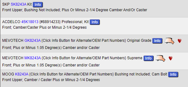

I see that some cam bolts sold offer 2-1/4 degree camber / caster adjustment.
Do they actually increase the range of adjustment available for camber and caster? Are they worth the trouble? Or just stick with the originals?

Just trying to achieve some reasonable positive caster. Have re-bushed and ball jointed all of front end before and left side has had trouble getting enough caster. However, I have had problems that I am now resolving with worn LCA pivot shafts. Also, I will thoroughly check the LCA and radius rod both sides to make sure that everything is equal side to side. Just saw these cam bolts supposedly offering more adjustment and wasn't convinced. I agree with other posts that the limit really is the slides that the cam bolts operate in, and I cannot see any more opportunity there. I will post the link on an earlier post.

Those cam bolts do not increase the range. The slots in the body where the UCAs mount are what determines the range of adjustment.

Here is a screen shot of what I have seen. However, digging a bit deeper the claims seem to be overstated. For example if you go to the Moog K8243A part number it then only talks about 1-1/8 degrees, which is really very much the same as the others. So sorry all, a false lead.

As per above, after thinking about it a bit more, I agree with your view.
