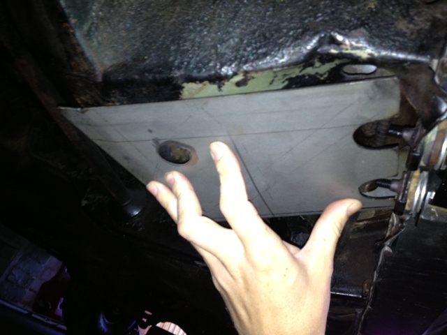

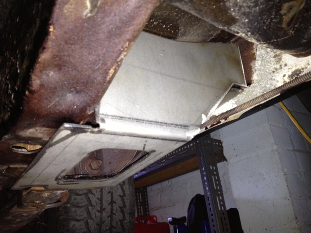

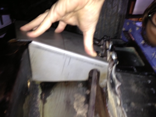

Just test fitting the US Car Tool torque boxes before fitting them and some subframe connectors, is this the right way? Seams like a fair way from a 'snug' fit, so I just wanted to make sure before I start bash, cut and welding.
Any advise? should the front edge of the panels line up with the edge of the frame rails etc? on the front one, that puts the front quarter bolts well out of centre if I do that...

For starters it looks like some of your frame is bent all to ****. That caint make it too accurate right from the get go.

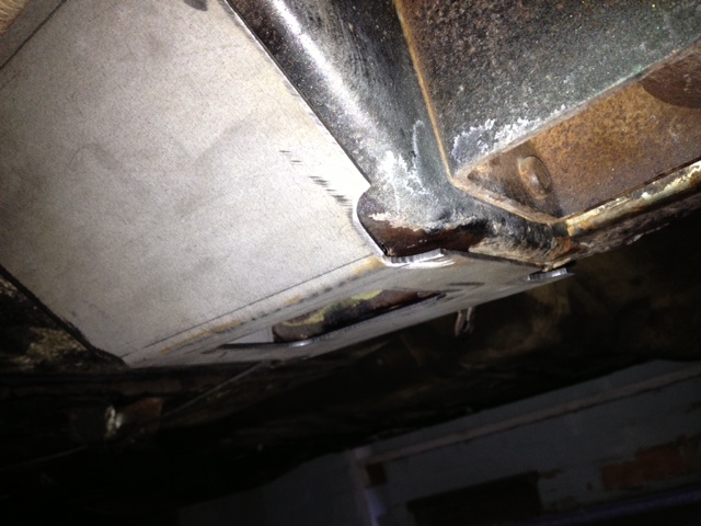

And Yeah, that's a hell of a kink in that rail, thanks for the pictures i'm going to keep them for reference. I'm making the torque boxes
RRR; You mean the last pic? Thats the L shaped brace that comes out from the frame rail to the door sill. Only just saw it when I went to test fit the boxes. Was thinking about heating and using a combination of hammer and pulling on a bolt through the hole to try and straighten it up.
Besides that tho, are they the right positions? I've just chopped a piece of 2.5 x 1.5" for the frame rail and was test fitting it with the rear box and there are some massive gaps. About a finger width. Obviously my cars been around the block a few times but its pretty massive gap.

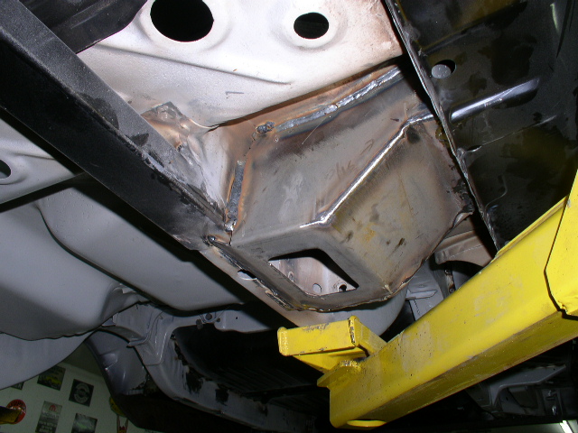

I put the US Cartool boxes in my Charger not to long ago. If this picture doesn't post, there are more on page 5 of my thread on the resurrection. We spent a few hours modifying the pieces to make them fit nice. The worst was adding material to the curved portion that butts up to the floor. Overall they are not that bad and a lot cheaper than the original style repops selling for $350. We put the frame connectors in first. Make darn sure your frame is straight and level and held in the correct position before welding any of this stuff in.
