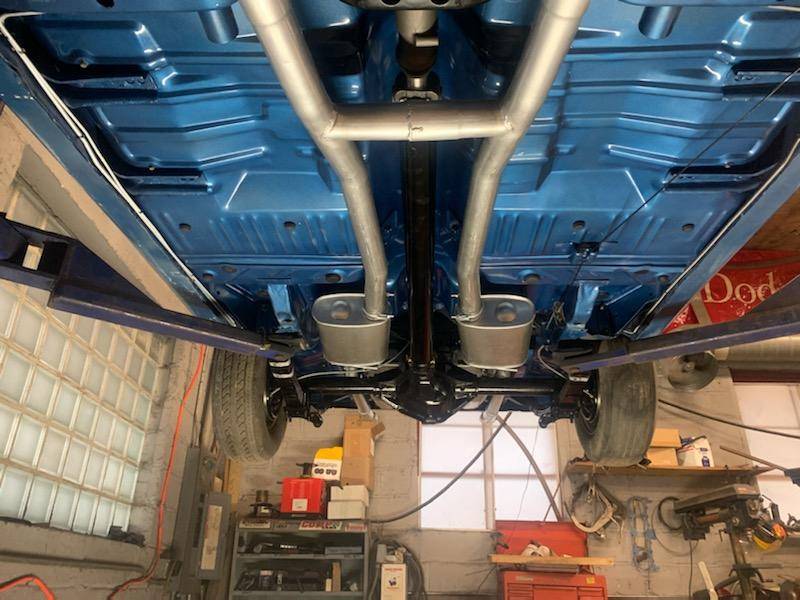

Torque boxes, subframe connectors, and inner and outer front spring hanger plates are installed!

I know these torque boxes add strength to the car body. So here is my question. Is ur car devalued by this mod? Numbers matching or not as ur car is not factory original anymore. Thanks. Kim
Hotchkis makes a bolt in subframe connectors that bolt into the four bolts that hold in the front leaf spring mounting brackets. I probably would have went with those instead of welding in aftermarket torque boxes. Now that I am keeping my 70 Charger R / T V code car, I am considering putting them in it,for that very reason, I don't want to do any mods that will devalue the car.
This is one of "those" decisions, effect on resale value vs the necessity and/or desire to make a modification, where effectiveness is weighed against diminishment in resale value. One of the reasons why I chose the USCT subframe connectors is because they weld in their entire length and follow the zig zag of the floorpans, making them the most effective subframe connectors available.
You see, for me, the greatest VALUE of my car is the ENJOYMENT I have in all aspects of ownership, and that includes the performance of the car.
