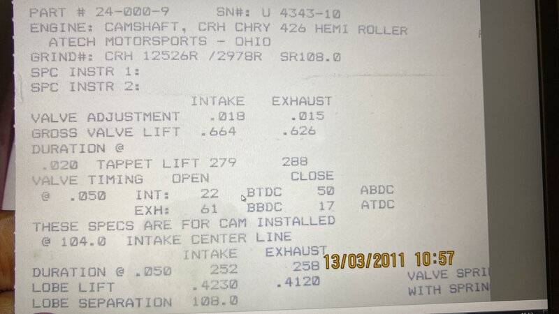

second question : the valve lash written on the cam card everytime talk about “ warm” engine , right ? if on cold you must add something , right ?
And I have to add also something because I have a cast iron short block and aluminum heads , or just what shows on the cam card ?

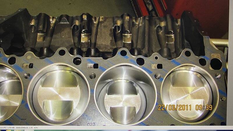

Third question: for what are the “ notches “ in the cylinder bore “ on my short block ? And have this done after it comes from the factory by the engine builder, or is this notches make by the factory ?

I am gonna guess the notches on top of cylinder bore is for valve clearance.
Are you talking about the chamfered edge around the cylinder bores? If so, that's usually done at the factory to help the pistons slide in easier without ring damage. Some blocks have more than others. Some have more on one bank the other bank, too..if those are notches at the top (tough to tell on my screen) it could have been by anyone, for some valve clearance.

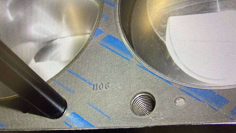

I think the notch he is talking about is at the 12 o clock position in the cylinder bore, it looks to be covered up by head gasket, in his photo.
MoparJack 489, can you post a few photos of the deck with out the head gasket in place?
The notch is for the intake valve clearance. I think beanhead is mistaken, the rocker arm to valve stem clearances increase when it cools and tightens up when it gets hot hence valve clatter with a solid lift cam before the temps and oil pressure come up.
I will do tomorrow , but I think the guys a right and the notches for intake valve clearance

Ok, thank you very much . If I understand you right , and you set valve lash cold first you subtract .003 from intake and exhaust from the cam card . My cam card says .018 intake and .015 exhaust ( hot)
I not understand because I think if I check it cold I think I must add some valve lash , not subtract ?
and what about the cam card , ok everybody say that’s the numbers for “ hot” check !
But what’s about cast iron and aluminum ?
the cam card ist just for cast iron block and cast iron heads ?
And if you have like me a cast iron block but Aluminium heads you have to add or subtract something ?

Thank you very much , very interesting . And it’s also that’s what dvw says , he Substract my cam card advice , because I have a cast iron block and Aluminium heads , means if they go hot the lash goes tighter then cold , right ?

That hot lash spec is determined (recommended) by the cam designer based on the ramps and whatever voodoo dance they do when they design it. With aluminum heads, on an iron block, start your cold lash .003 tighter--so .015 intake--just as DVW suggested. This will get you close to the cam card spec when hot.
The thing with hot checking, is things begin cooling quickly so only check a couple valves on one side, immediately after running and note the lash. If it's not quite where you'd like it, wait until the next morning when it's good and cooled, then adjust to make up the difference. So for example--if your hot reading was .020, and you wanted .018, go another .002 tighter on the cold lash. If you try to adjust them all to hot spec after running, by the time you work your way around the engine they will all be a little different due to things cooling off.

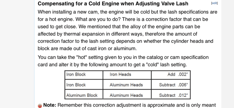

But what means this list , they add all the time in cold condition , with iron to iron and iron to aluminum
Sorry , they also subtract from iron to aluminum heads about 0.06 . Perfect , understand . But you guys recommend tk start with 0.03 subtract in cold check conditions . thanks at all, I learn and understand a lot this hour more about valve lash
View attachment 973277 But what means this list , they add all the time in cold condition , with iron to iron and iron to aluminum
I think you'll find that chart to get you very close. For aluminum heads on iron block, they're subtracting lash. Going by their numbers, you would cold lash your intake valves to .012". The .003 tighter lash was suggested as a starting point. You may or may not need to go more.
Remember--it's all relative to how your engine performs at a given setting. You may find your combo picks up some pep at a slightly different spec than the card. Trial and error is the only way to get it truly spot-on. Target the card spec as a starting point and you won't go wrong.
I am also fairly sure he is right, as I had written, way back in post #2!! :rofl:
:lol:
I just figured with head gasket off the notches would be much more visible.
