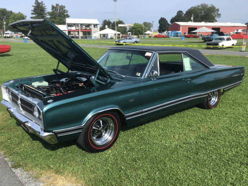

I am in need of some advice on '67 383 4BBL fully rebuilt 15 years ago with approximately 30,000 since rebuild.
I am seeing a good amount of blue smoke upon startup and lesser amounts of blue smoke until the engine is warm. Once the engine is warm, I don't see any smoke.
I assumed valve stem seals when I saw the smoke on startup, but I am wondering if the seals would also cause smoking until the engine is warmed up. I should also mention that I am hearing a mild knocking (lower pitch sound than lifters) when the car is first started until it is running for about 3 minutes or so. I have looked through as many posts as I could find on the topic as well as other sources. The knocking has led me to discussions on "piston slap" etc. (rebuild included Keith Black hypereutectic forged pistons). I'm not sure if the knocking and smoke issues are related or not. I haven't done a compression test yet, though I understand is may be a good next step. Any and all thoughts and suggestions are appreciated. Thanks in advance.
