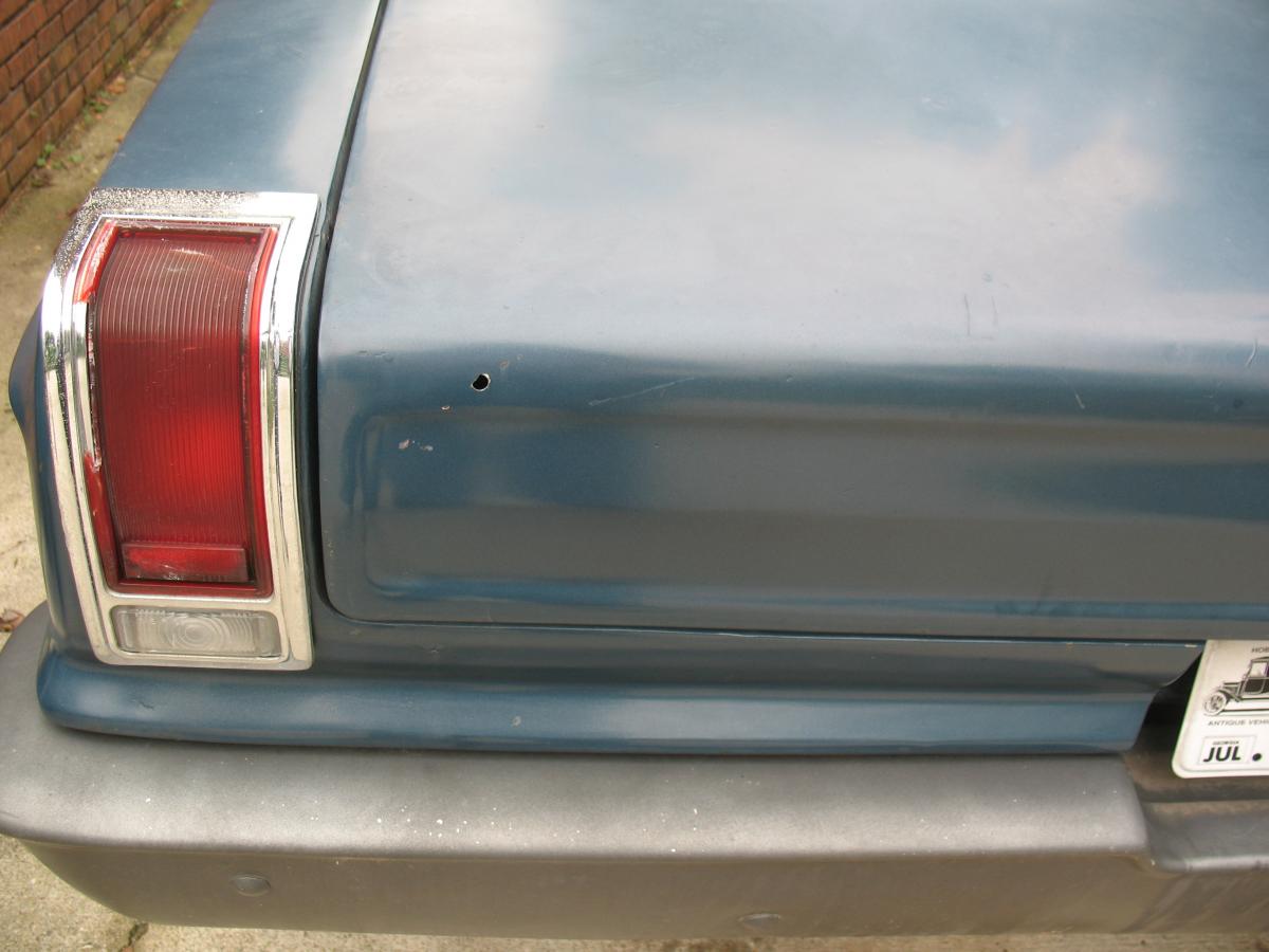

I have a 65 Dodge Coronet 500, however it has a few differences I'm questioning. The tail lights have the plastic lens that goes up over the rear fender (picture attached), NO shiny chrome plate. It is a 2 Dr. Sedan and doesn't have the chrome plate across the trunk lid. The Vin Number is: W457217882 and when I look up that vin it says W45 is a Coronet 500 2 dr. convertible?? What gives, are these car specs really that far off, or was record keeping really that bad :)
For 1965 the w means coronet 8cyl., the 4 means premium coronet, The 5 means the model year and the 7 is the assembly plant which in this case is St. Louis Mo. The rest is the vin sequential number. How did you come up with convertible in the vin you provided?
