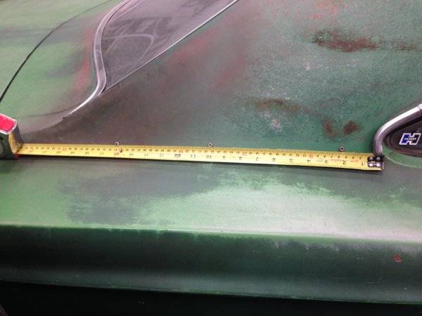

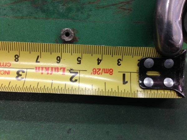

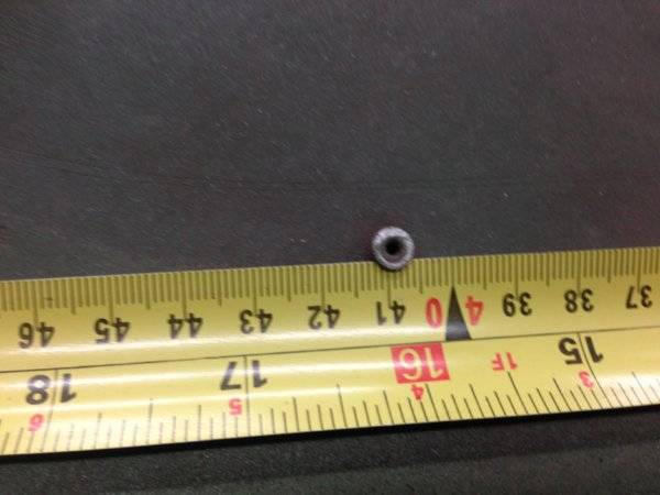

This is my 69 rr. I have no idea if they are original or replaced. The top is long gone and the other side has no clips at all. However, if it helps........
Thanks gdrill. I will check the measurements tomorrow.
