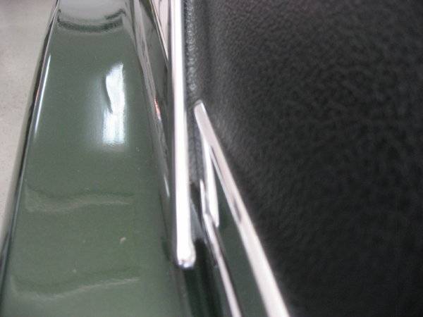

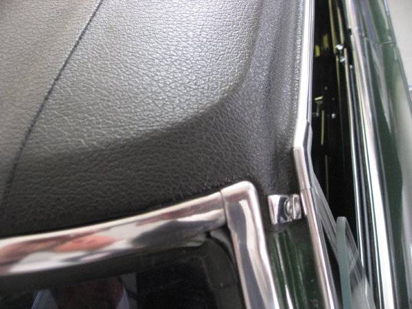

Here's my '66 Coronet 500, original paint & vinyl top. Looks like it does go under the drip rail moulding.
Believe it or not, the vinyl top replacement "how to" is in the service manual shown in the Body & Frame section.The vinyl goes into the gutter and is cut up and over the drip edge. The trim is then snapped over that .
