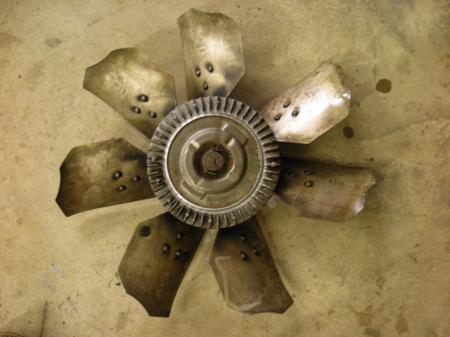

I can't find a new Mopar Viscous Fan Package because they stopped making them so I bought a used one on ebay. The problem I have is one of the blades has a tiny kink along the one edge and I wanted to know if I straighten it (which I believe I can easily do) will it be okay or am I better to find a different one? Maybe I'm thinking to much but I don't want to have it sprung and out of balance and cause problems later. Thanks, Alan

I sure don't know if your's is hurt beyond repair, but mine has worked well beyond anything I ever expected. If the thermo clutch is working properly, hammer out the ding in the fan blade. If not PM me & I'll send you mine which is perfect. I'm headed toward a "drag only" setup. My current viscous setup has worked incredibly well.
I'd say go ahead and hammer out the ding. Lay it face down on a flat surface to check trueness. Or after you bolt it on, use some kind of reference to check each blade location as you spin it.
