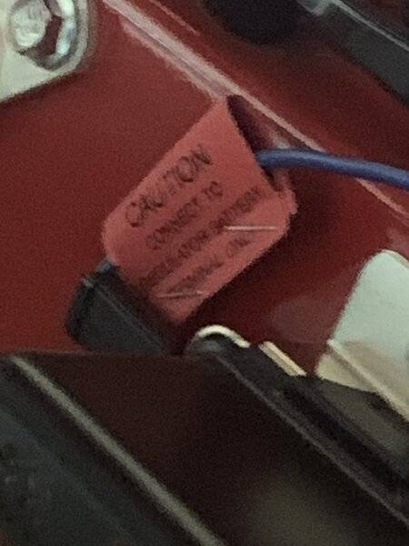

I'm trying to determine which wire this caution label is to be attached to. It says "Connect to Regulator Battery Terminal Only. The regulator has two terminals, one ING the other FLD. The only Battery Terminal near the regulator is on the starter relay. I haven't seen any photos of this label as it was originally installed. It may be obvious, but I don't get it. Thanks for any advice. The car is 1962 Max Wedge Fury.
The battery terminal should mean the ING (ignition) terminal. I looked in the factory service manual for pictures, no luck.
The discrption in this ebay add states it goes on the wiring lead to the regulator but you can't always take the word of just one person. I don't believe having this lable is related to just Max Wedge. A factory picture is what we need. :)

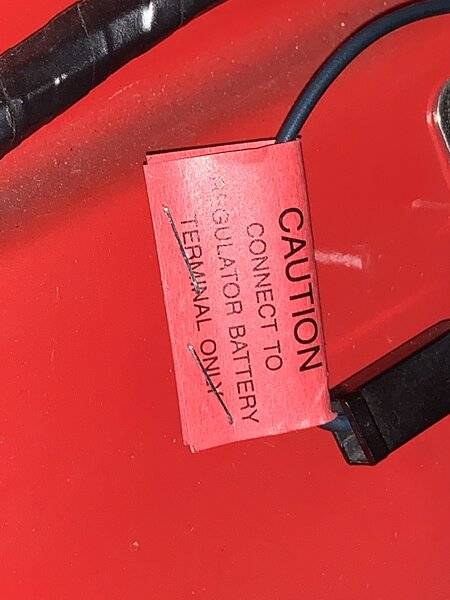

I was curious about the size of the lable. That pic puts it in perspective.
I believe the label was designed to be folded over the wire with the two halves then stapled together. I have no evidence to support that belief, but it seems logical based on the way it's made. Someone out there knows the answer. What's troubling, is why Mopar would refer to the VR's "BATTERY" terminal when the VR has no terminals labeled "Battery". It's just an insignificant matter in the overall scheme of things, but it's annoying not to have a clear answer.

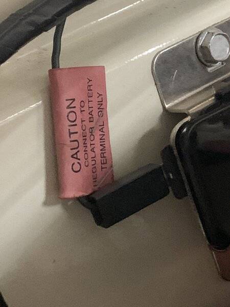

Here is a good photo of how it goes. Fold it over the wire and put two regular staples each at a little bit of an angle along the left bottom edge and the second on the right bottom edge.
