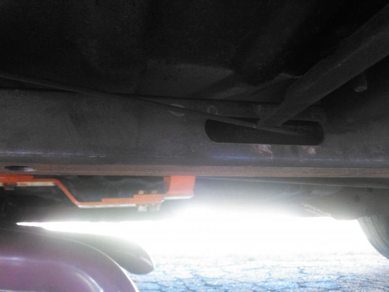

Sub-frame connectors in. Should have painted them pink. I'm losing my fashion sense.

lol
they look good nonetheless, Bob-O
Hey Mario, Checked the b-pillars and sure enough, the paint was cracked. Hopefully the connectors will sure that up. Thanks again for the heads-up.
May have just caught it right at the beginning. glad to help a fellow MoPar brethren!
Sub frame connectors is 1/2 of it... hemi boxes and boxing in the radiator with square stock... then weld up all the seams from bumper to bumper inside and out. = strong with out going with roll cage and tube frame.
pretty common problem in B-Bodies, with any real power,
sub-frame connectors & torque boxes should help {roll bar would too}

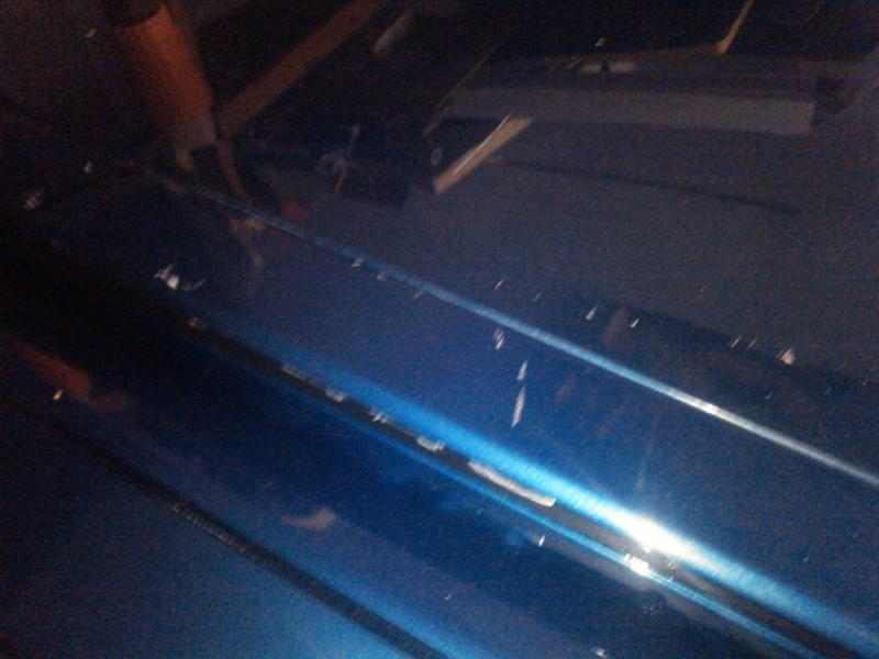

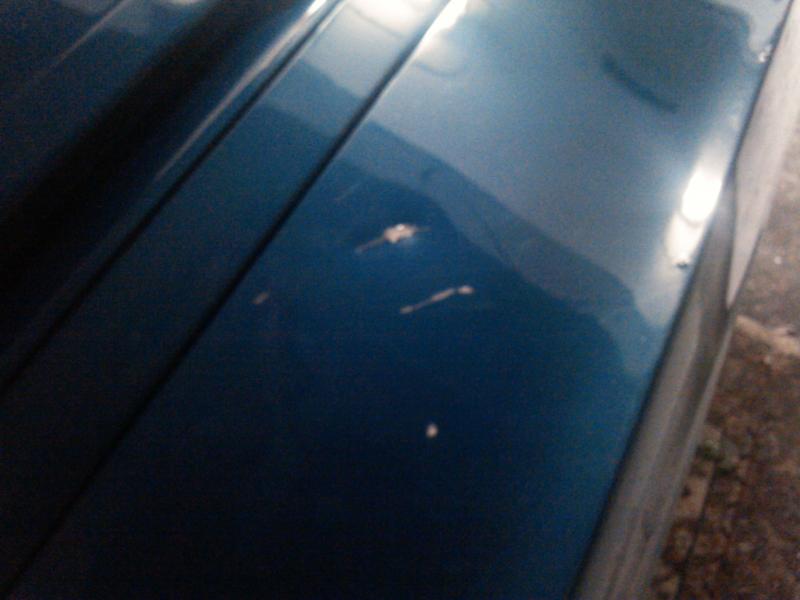

Well, the GTX lost a battle with the circular saw today. I started the car and the saw vibrated off the shelf and smashed my fender and scratched up the hood. I guess its God's way of telling me to put on a fiberglass front end.
You done dared.
that'll buff out. lol
don't feel bad, my daughter dropped a 10 gallon fish tank on the fender of my limelight 440-6 cuda years ago. She hasn't been seen since.
