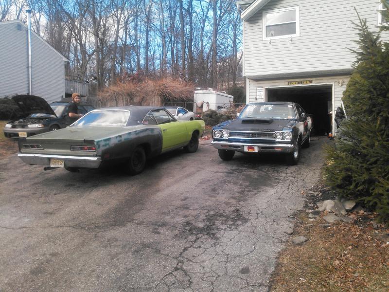

As an added bonus, We got beast Jr. on the road today as well. While tracing wires on the coronet, I found a loose connection which was causing a no spark deal.

Well I am glad you found your gremlin :icon_thumright:
Now put intake back on and run it!:icon_smile:
