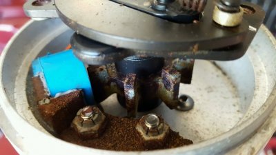

I rebuilt the carb and took apart the dizzy.
The reluctor is rusty.
The pickup assembly the same.

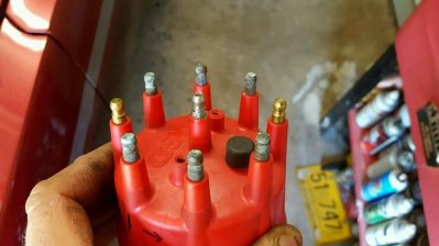

look at the cap....
I saw that and decided to pull the wires off. I ohm'd the wires and was only able to get a reading on 2 of them and the coil wire. NO reading or continuity on all the other wires.
Look at the cap again.
The only wires that were reading were coil, "2 and "3.
coincides with terminals on the cap.

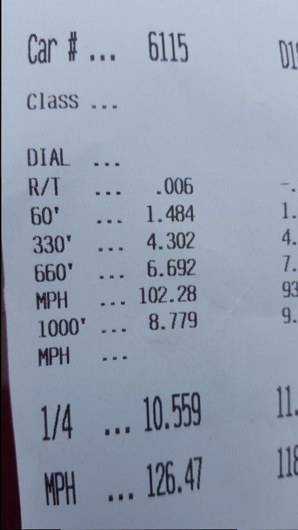

First pass out I ran 10.80. Car was loose so I had to peddle it. Next pass was my time shot. Car was better.
