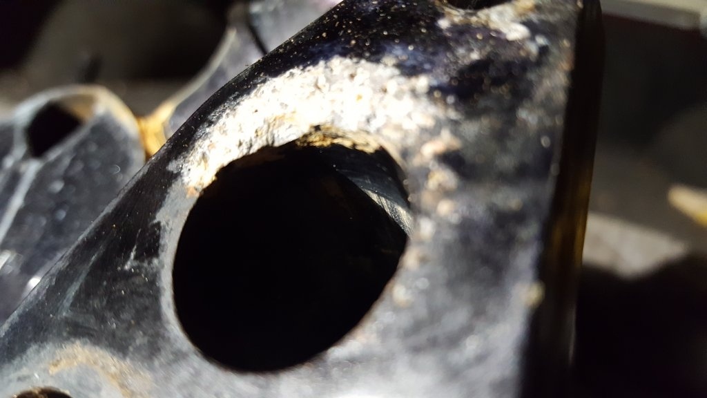

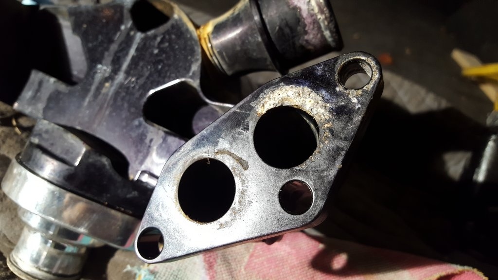

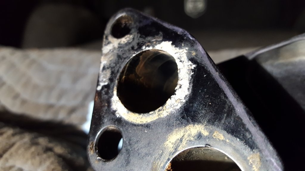

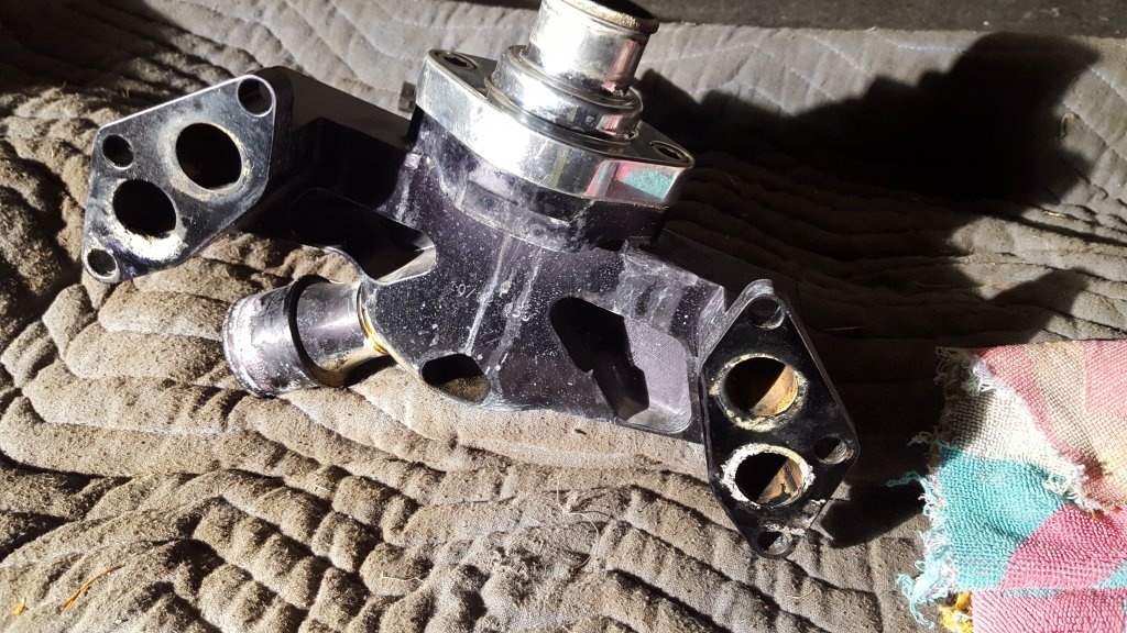

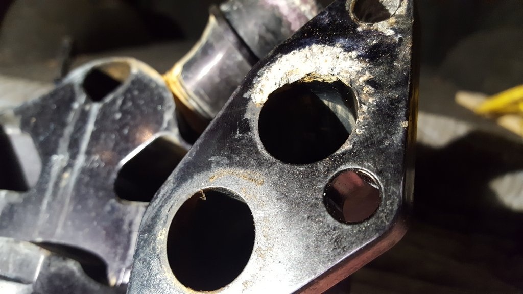

Personally I'd clean it and use RTV. GM grey will seal it. When I was a GM dealer tech I repaired 100's of pitted 3.1/3.4 intakes with it. NEVER had one come back. Or if you're picky just machine it. No need to weld it. So it's .100" thinner, won't matter.Meziere water pump.
Weld and machine?
Damage extends 3.76 mm down.
View attachment 372787 View attachment 372789 View attachment 372790 View attachment 372791 View attachment 372792

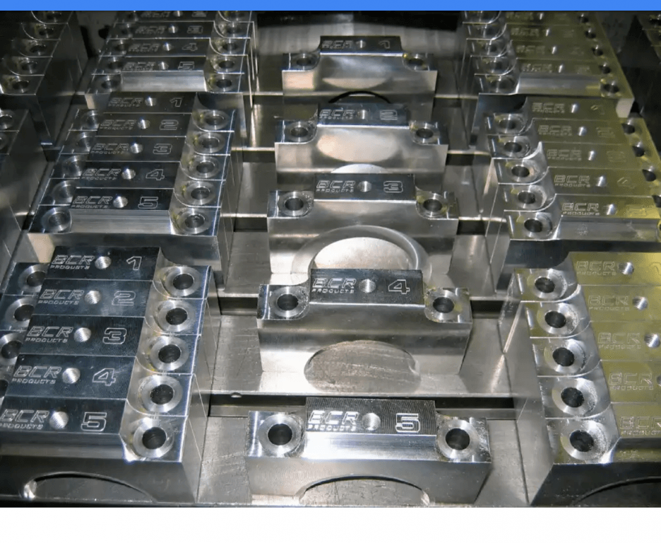

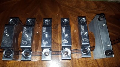

Perty billet main-caps there Bobby
