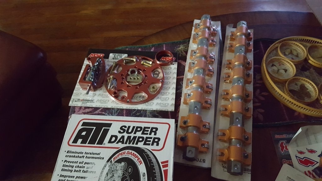

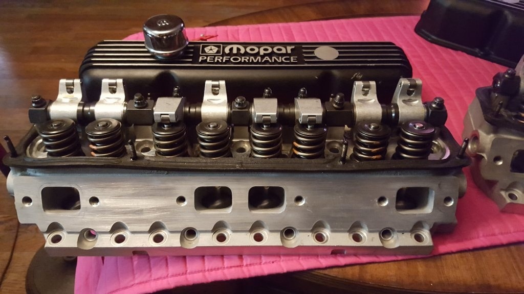

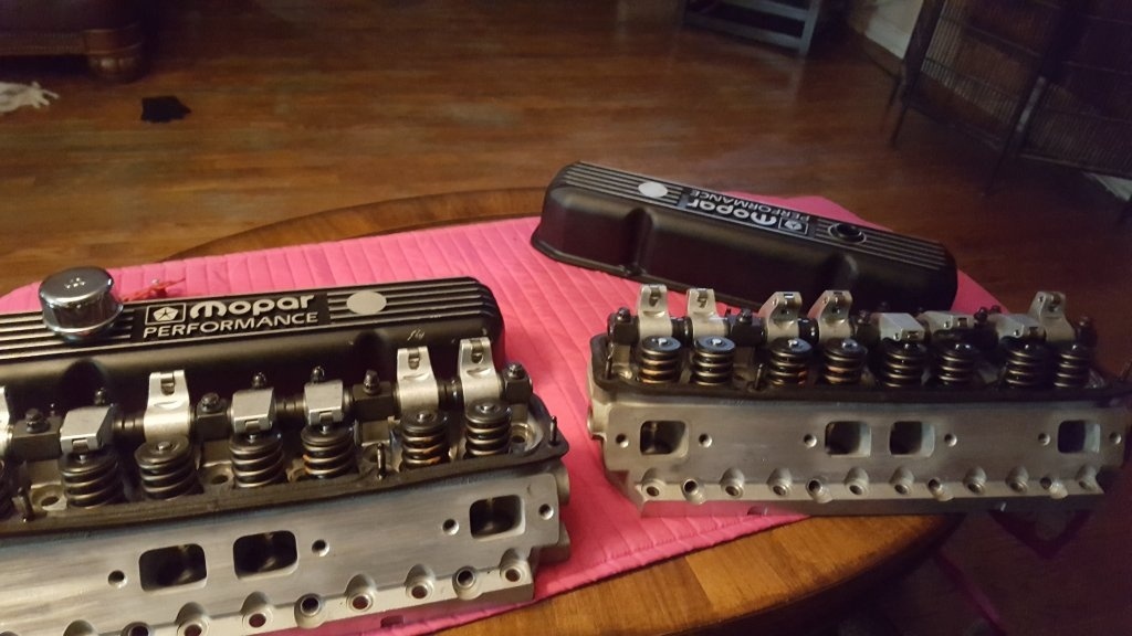

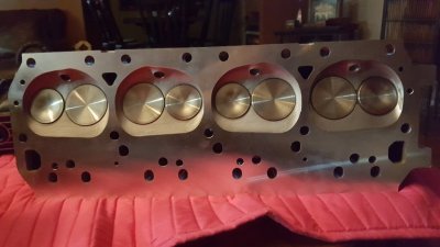

The Stealth heads are all fixed, new Manley valves, all new hardware and springs. Hughes rockers installed and ready to go.
These are going back on the GTX motor and going into the kids Coronet.

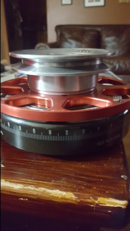

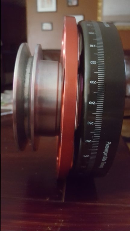

Can you post up about adapting that ATI dampner with the pulley spacing etc..?? When you get to it.
I was about to go that route but the spacing for the pulleys made me wait on it for a while.
Im working that out now. Not only a different damper, but crank trigger too. Ill post what I end up with.

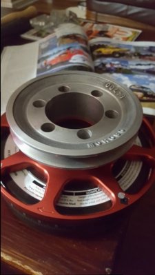

This probably won't help you at all.
I am only running an alternator belt so all I needed to do was take 5/8" off the bottom of the pulley for alignment.
