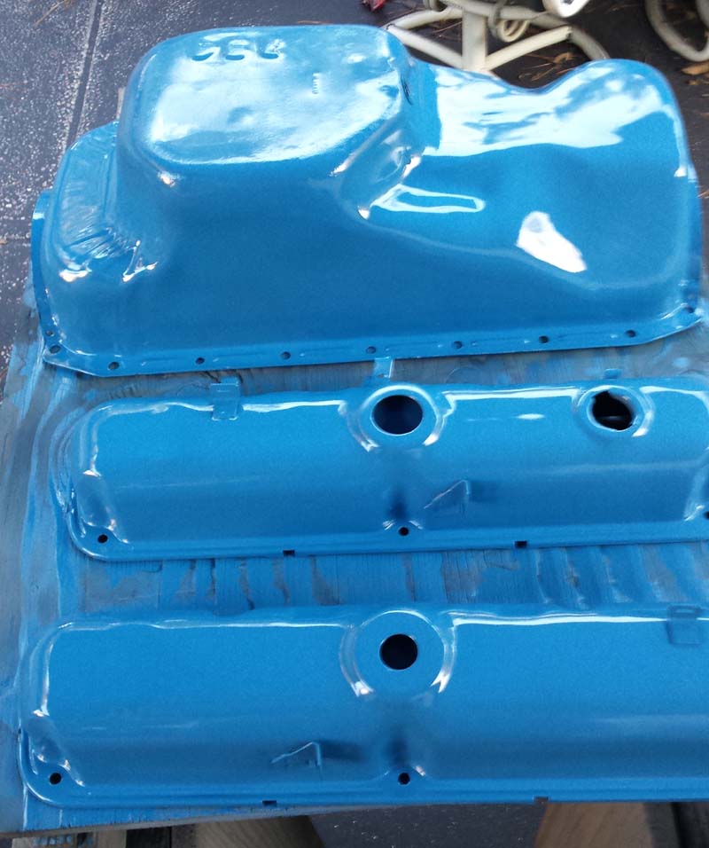

I went to big name auto parts store and only found the darker blue Chrysler paint. so I went to A&M auto parts it a old school part store the had 2 can of Chrysler blue that looked like the color I have been looking for. I painted my valve cover and oil pan with it.

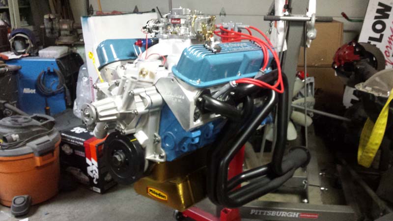

I get to pick up my 318 stroker Friday. ordered 2nd oil pan do to the 1st one was discontinued should be in next week. Hopefully I can get it installed before Christmas.
The Harlin Sharp roller rocker I ordered did not work with my Edelbrock 60779 heads. the roller started rolling off the valve stem at half stroke. I ordered a set of roller rocker from Hughes Engines they make a set for the Edelbrock heads I have. should have the part by the end of the week then I can finish building my engine.

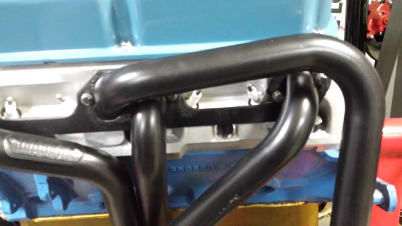

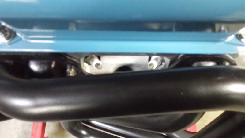

I worked on my engine this week end and I'm having issue with the headers on the left side conflicting with the spark plugs. Is this typical with a small block LA engine in a 1973 Satelite or Road Runner. I checked out other manufactures and they all seam to build them about the same in regards to the left side. I'm thinking about reworking the header tube to clear the spark plugs.

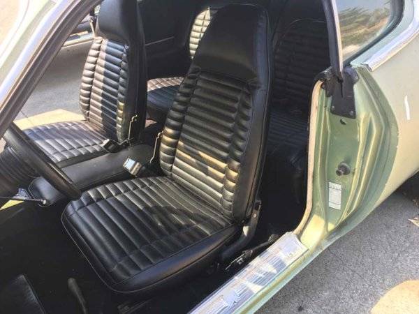

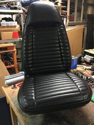

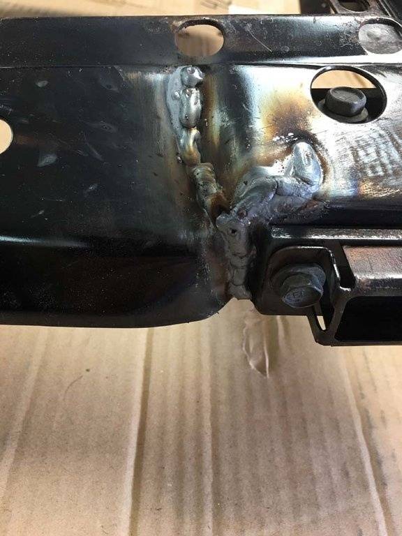

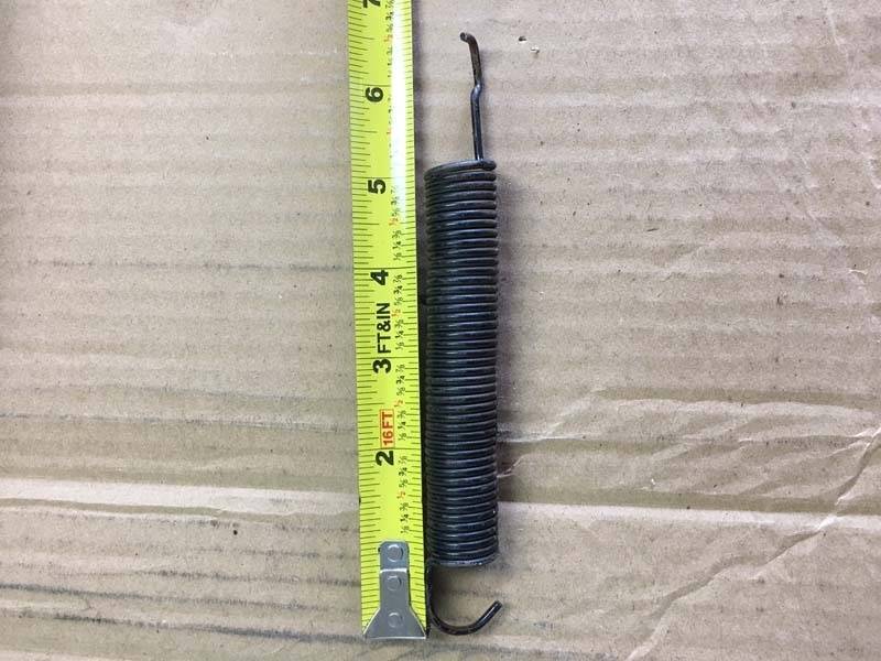

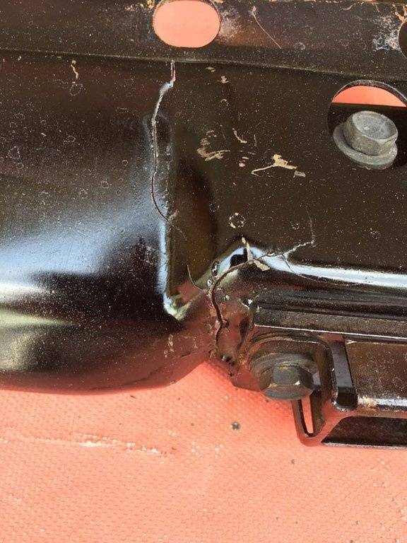

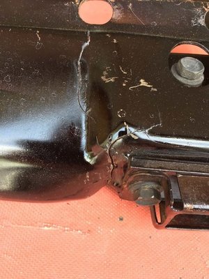

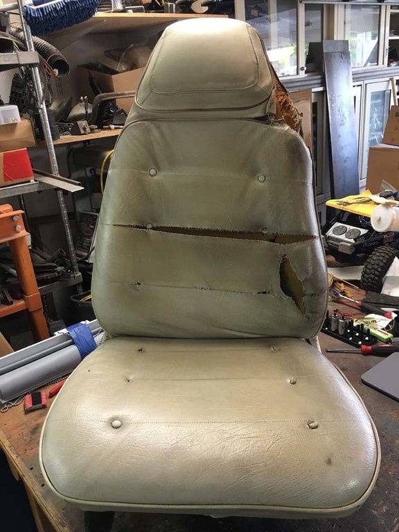

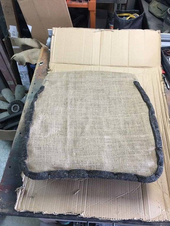

It's been a while sense I posted. I final got my transmission issues worked out several months ago. I installed 8-3/4 rear end with 355 gears and locking diff along with disc breaks. I just finished replacing collapsed lifter. Edelbrock replaced it and gaskets under warranty even though it has been more that a year. I installed FI Tech fuel injection and it was pain to get working. burned up steering column wiring because of it. in the end it was programming issue with the cranking RMP's not low enough to create spark. Started recovering my seats my self. After watching couple videos its quite easy. An upholstery shop I went to wanted $2,200.00 I buy the upholstery covers they install them. $5,300.00 custom seat covers. It cost me $1,475.00 for new foam upholstery covers and install kits for both front and back seats including the arm rest. The driver seat I had to weld it up the frame was cracked. I added pic of the spring for the front seats I'm missing 1 if anybody know were I can get one.

Nice find, looks like a great start. Another vote for the slots !
Good to see you went with the 72 seats instead of the 73/74 covers. I did the same thing with my 74 Roadrunner. The 72 covers look much better.

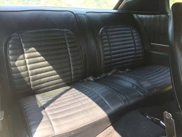

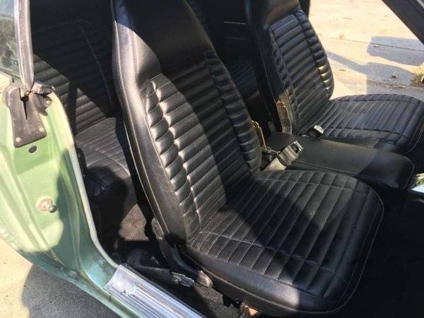

Completed my interior is finished. I replacing all the seat covers and painted the white interior black. very happy with how it turned out.
