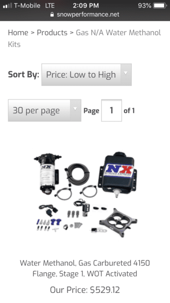

Anyone using a setup like Snow Performance for a non-boosted carb street driven car? California summer temps and ethanol laced 91 octane pump gas make for a bad recipe of fuel boiling and vapor lock. I have insulated all fuel lines and don’t have problems most of the time but if something like what Snow Performance offers can solve this issue and give me crisp strong throttle response like I have when I take the car out at 6:30am at all times of day and temp, that would be awesome.

What about just installing the snow performance system without a pro charger or similar system? Could I expect any gains?

W/M will lower the temps in the intake making the mix more sense and colder air makes more power.Either way you need to read the plugs unless you have o/2 sensors.
Water meth injection won't help with vapor lock and fuel boiling in your carb. If you have detonation on your setup it will help in a non boosted application, or if you have your timing backed of to prevent detonation you will be able to tune for more power. You also would be able to use cheaper low octane pump gasoline.
