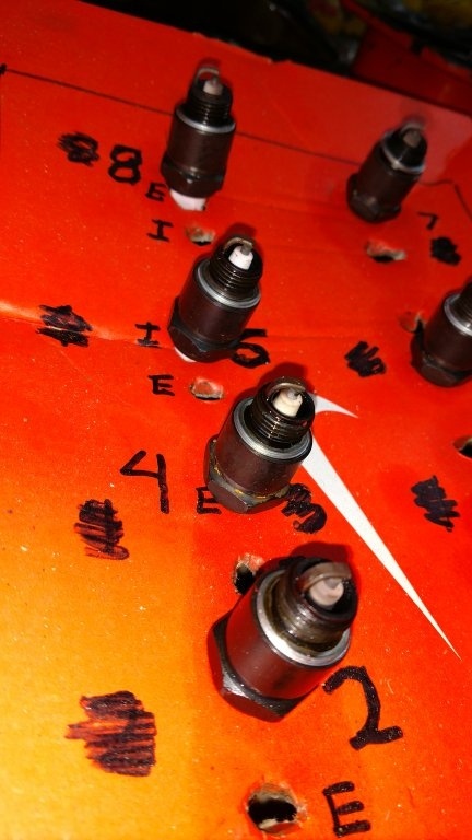

Spark plugs removed.
To me, the center plugs look like they're running lean. I don't know what fuel you're running. I like to see a little tan color.Anyone seeing what I'm seeing with the plugs? Dang things only have a couple hundred miles on them BTW.
Yeah, definite color differences between middle plugs and outboards, agree.To me, the center plugs look like they're running lean. I don't know what fuel you're running. I like to see a little tan color.

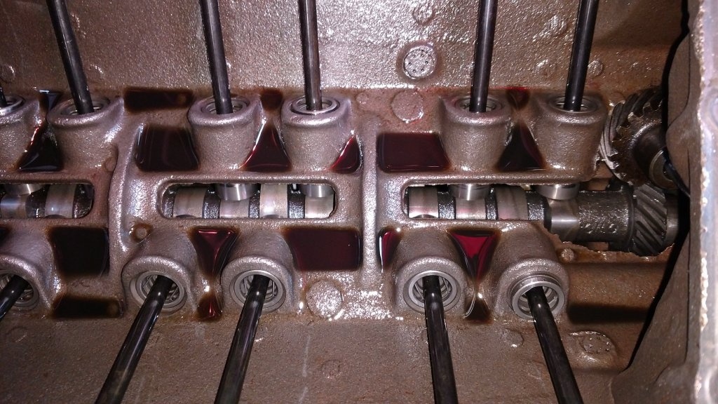

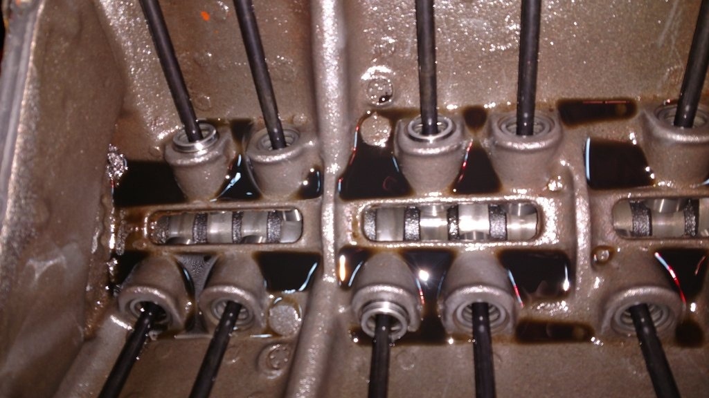

Looking at the pics of the valve covers being removed, things look normal. Did you try to fire it up and listen and watch what's going on? (I know it makes a mess)

Looking at the pics the cam lobes don't look too bad. The two at the back of the engine, looks like the wear pattern is off center. But that might be the glare in the picture.No, I did not start the car at any point today.
Yes, these pics are being taken live as I tear it down right now.
Yeah, I was out there anyways.Looking at the pics the cam lobes don't look too bad. The two at the back of the engine, looks like the wear pattern is off center. But that might be the glare in the picture.
I was hoping you would have started it with the covers off to see or hear what was going on.

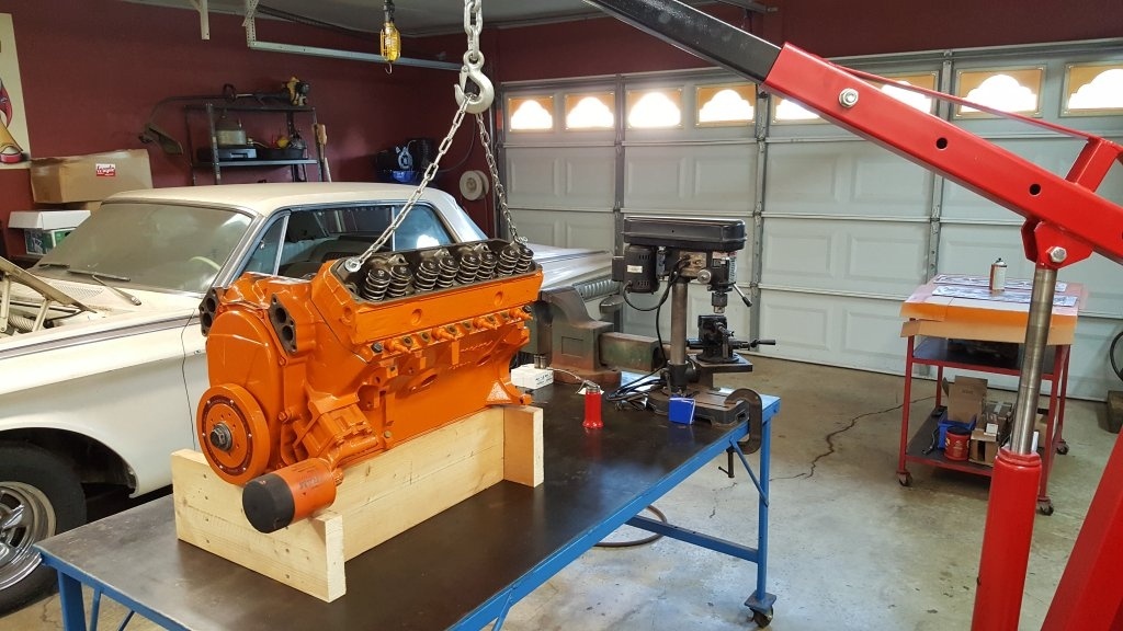

I hear ya. They will pick your feet off the floor!When I took off that 500 lb. factory intake, about broke my back.
Called it a halt right there, cleaned up.
Yep, I did this engine with mine by myself last time around. Only way to fly.I hear ya. They will pick your feet off the floor!
I use my cherry picker every chance I get. I remember r and r transmissions, by hand, laying on my back. Not anymore!
I did a compression test last year before the head swap. All cylinders were within 5 of each other, averaging 130.Before you go any farther Id do a compression check. A couple of the plugs look either a little lean or couple look a little rich. Get some baseline info, cam doesnt look too bad, although the wear pattern on a couple of rear lobes look a little close to the edge.
It's the same cam, actually. It got swapped out way back when the engine immediately wiped the cam I got it with (some sort of Mopar purpleshaft - sounded like a 509 when it ran).Looks like the last cam change did not solve the problem with the plugs burning clean also looks like the same cylinders as last time. The heads were done recently so it should not be a valve problem.
The only thing you have not had apart is the short block. Time to get it out and get it done.

Pretty much, yessir. It appears as much to me as well.Some of us are just pig-headed and want to figure it ourselves.Been there/done that!!Reminds me of years ago at GM dealership,rattling noise in top of small block,kept moving around side to side. Pulled intake&heads,a few minor dings on top of pistons( what caused this???) nothing found,cleaned & put back together. No more noise; less than 5000mi under warranty; never heard anything else about it ??????? Forgetting all the previous posts- carb/intake flow problem with lean middles & rich #7&8 plugs? Lobes look good to me..
I agree....and I'm now thinking of the only thing I know of that fought me when putting these heads on - the intake - especially since the valvetrain looks ok, oil is laying everywhere it should, nothing is physically damaged, etc.I do remember drilling out intake bolt holes to 7/16" to compensate for slightly lowered heads when they were cut to be flat. I don't remember the particulars when going to a mech. lifter cam; maybe I got lucky with pushrod length, see a lot of posts about that problem on some of these posts. 'IT' was WAY simpler 'back then'.!!!! I still think you have a 'simple' problem that has floated past everyone.(?)
