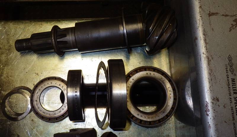

Well, not necessarily. This large stem came out of a 489 case. A tapered pinion set went back in...…….
