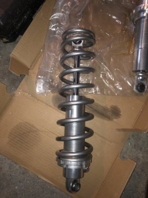

Whatever you get check your parts to make sure they are correct. My street lynx sat in the box for a year before I installed and once I did install I found out he had sent me a mismatched coilover set up. 9” shock and a 12” spring. Spoke to bill and he swears there no way I got that spring on the shock if they are what I say they were (ever hear of a spring compressor?) Even with picture evidence he simply stopped responding to my emails. Got with PST and got the correct length shock and spring ordered, cost me over $600 extra. Photo attached clearly shows the spring is too big for the shock.
