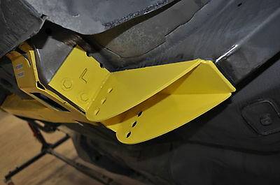

    On my 70 Roadrunner, I may mini tub.
    What does a "spring relocation kit" with the Gerst triangulated rear suspension look like or do compared to a relocation kit for leaf springs?

    He offers an inboard lower bar setup, so you can use with a mini tub and leaf kit to gain as much room as possible for tire size.

    This is what I mean by relocation kit, then with the inboard lower bar you gain tons of room. The top bars have no dog in the fight, the bottom if they mount in the stock location you wont get any better clearence.

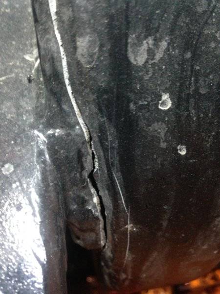

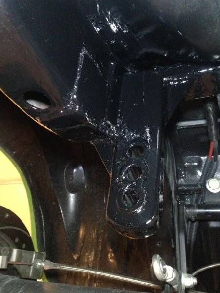

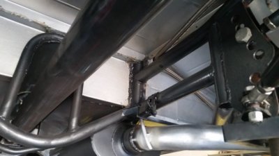

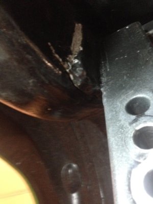

              I run a 4 link with panard bar. It has worked good. I did have to plate the frame from all the G-force of racing a 4000# car.
              I switched to heim joints when I fixed the tear in the frame. I didn't notice a lot of vibration in regular drivability. But the car is pretty stiff so kinda hard to comment on that.

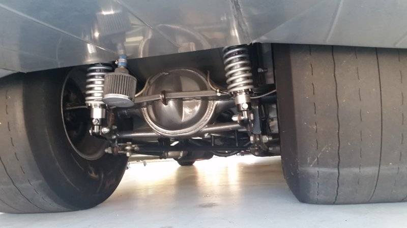

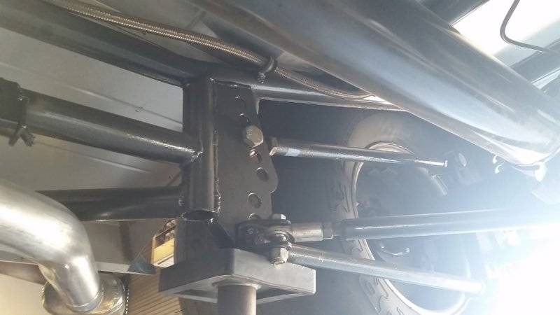

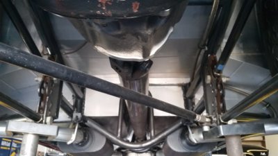

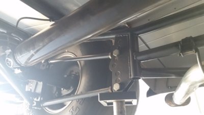

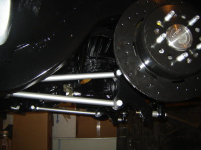

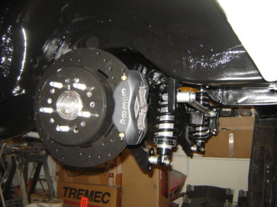

                  This is the true 4 link setup on my 65 Belvedere.
                  The car has a round tube chassis back half from the torsion bar crossmember to the back.
