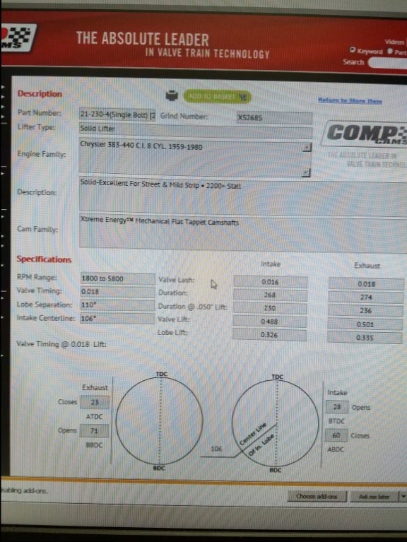

Mines fairly mild and works nicely on the street but still a healthy sounding idle.
Aluminum heads also let you run about 1 point higher in comp. But if you build good quench in it and run the right cam to keep the cyl pressure at or below 180 you can do it. Like was said the best build is run a flattop piston at zero deck and a closed chamber head. Then use a .039 to .045 thick head gasket for good quench. Myself I run the Indy EZ aluminum heads at 10.6 comp and a solid flat tappet cam thats 264 & 270 @ .050 with .585 & .592 lift and has a 110 LSA. I have it in the eng on a 106 ICL. I actually use the D-dished pistons as my comp would have been close to 11.8 with the flattop and the 75cc EZ head so the D-dish piston has a dish in it but about half of the piston is still flat so I still have good quench. I run 92 pump I get in my area with no spark knock ever running 37 total timing. With todays technology a good eng builder can build you a nice stroker with aluminum heads and about 10.5 comp to run good on 91 octane. If you use Iron heads keep the comp around 9.5. Good luck , Ron
