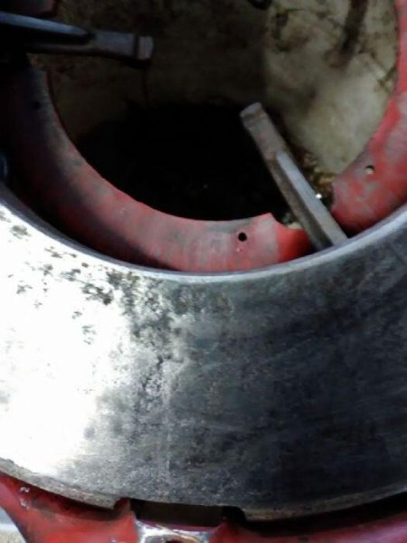

5th clutch in the hotrod... i have never seen a clutch cover do this...the whole face of it is like this.... it only .003 to clean up the flywheel. all good tho. i have more.lol

did it sit for a long time with rust on the surface ?

you would think it was on the titanic.. i put it in about 8 months ago... was new. just started slipping a few rides later.... flywheel looks like i turned it yesterday... post covid parts i guess. 5th clutch in just over 3 years. something is going on . just ain't found it yet...... yet.

That photo you posted shows a chunk missing on the pp? New or rebuilt?
Yes... Like that all over it. Thats the real bad spot. don't remember if it was new or rebuilt. is a BW unit. There going to get back to me.... lol
