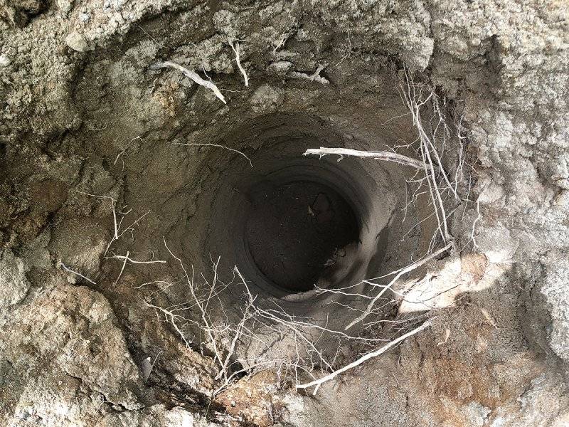

I drilled 16 holes for 12" building tubes this morning... Removed about 2 million rocks and boulders in the process... part of my shed expansion project

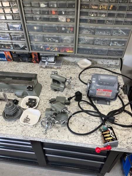

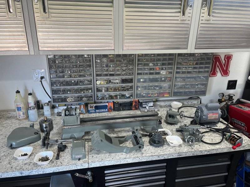

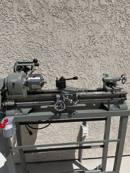

Assembled my Lathe
Bought a small Craftsman/Atlas 6in "101/618" Lathe about 2 years ago. I decided finally to tear it down, clean it up and re-paint the lathe and install larger casters to the stand and rewire the motor to add a drum switch so I would have forward and reverse spindle rotation. Prior to assembly I wanted to re-shim the carriage and re-adjust the all the Gibs in the slides taking out excessive slop.
This Lathe is small and somewhat limited because of size, but sure is nice to have capability to make or modify many fasteners and threading semi large parts. Here are some before and after pix.
BEFORE
AFTER

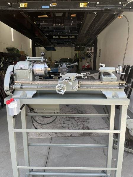

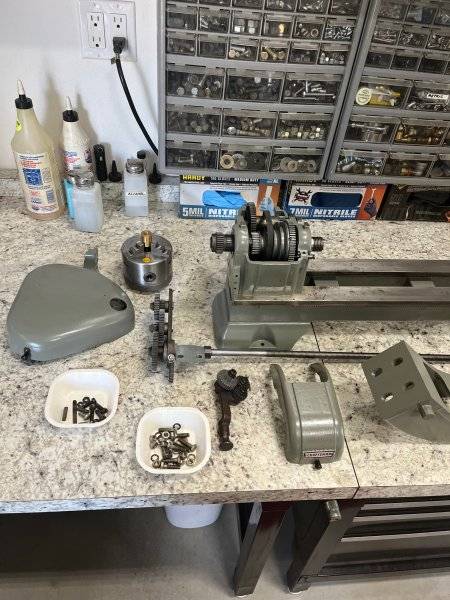

Assembled my Lathe
BEFORE
AFTER
Nice job! I have a 15" LaBlond Regal servo shift. Wasn't too happy about getting one with that servo shift but I've had it a lot of years now and no issues. They are handy for sure!!

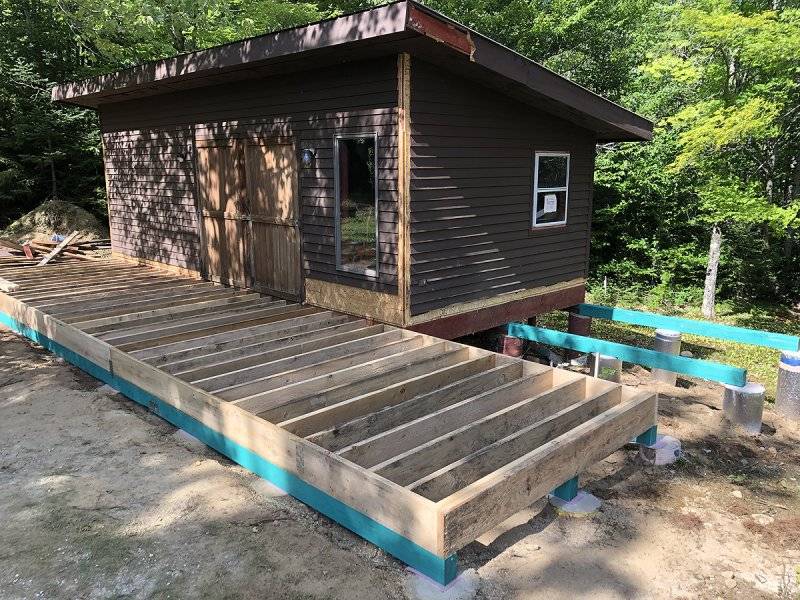

Started locating and planting tubes in some of those holes I drilled for the shed expansion project the other day.
