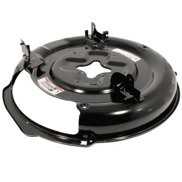

Don't. The clippings need a smooth surface so they skate out and don't build up. Putting a liner inside will cause the clippings to build up and clog the discharge chute.Deck rusted through in a few places on the 30" mower I have at the shop.
Found a new one on ebay.
This one was $150.
All others I can find are $250.
Looks like the exact same part.
This will be a fun project.
Might rhino-liner it before I put it on.
If anything, coat it regularly with Pam cooking spray.
