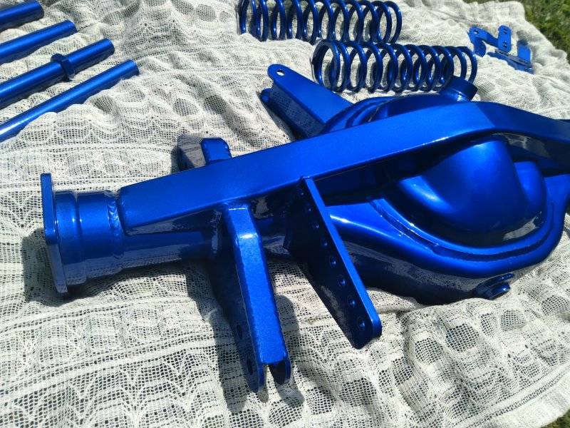

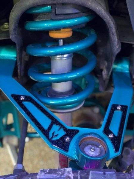

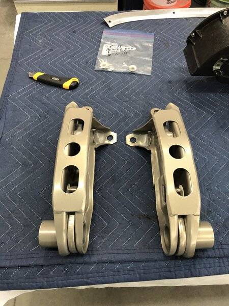

I restore and coat suspension parts all the time. It's not unusual, though most are done back to factory colors.
