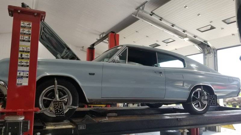

I spoke to the shop today and they have the car finished. With the replacement of all the bushings, alignment and wheel balance he figured 8 hours of labour. He wants $600 but I think I will give him a little extra.

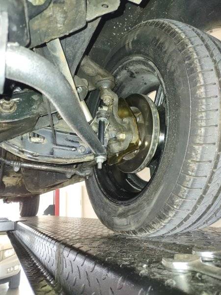

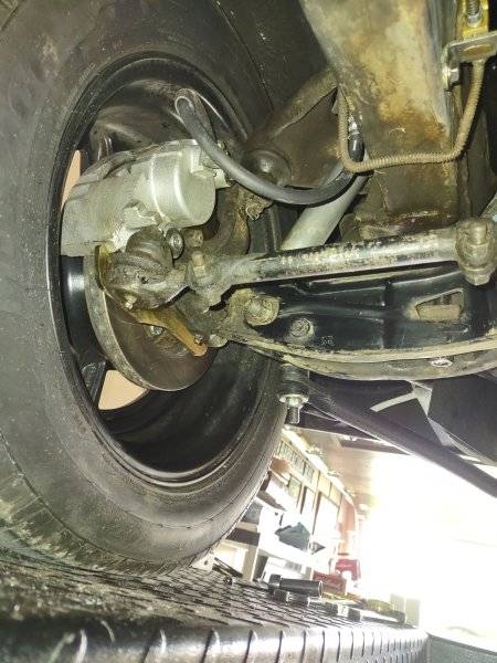

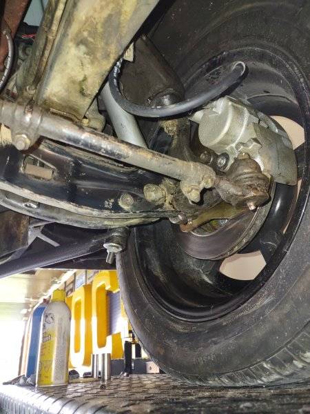

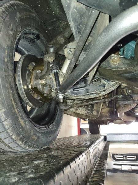

I checked over the front end today . I had to readjust the torsion bar height, and the sway bar links. I didn't repaint anything but I did hit the control arms with some brake clean. The car drove home just fine and tracked straight, so I think I am good to go for Carlisle.
