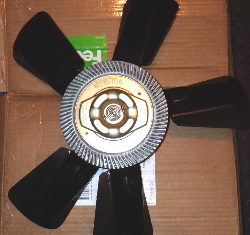

If you are looking for the original vicious fan package (like below) I have not been able to find them and have been told they are no longer being produced. Have to try and locate a used one or go with a 7 blade Hemi fan like I did.

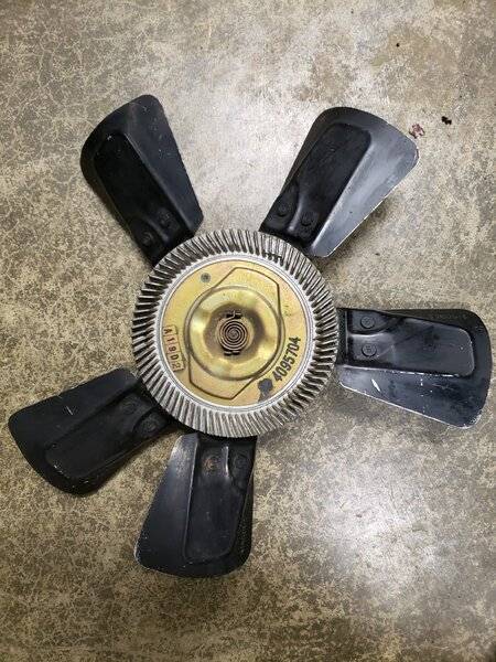

I have one that has been mounted but has not been run.

Just want to update this for reference as Mopar is still NS1 on these. The fan itself is pn 4140063 and was used on a slew of 1984-89 Dodge trucks including 6 cylinder engines.
The pn for the clutch provided with the kit is 4095704 (or possibly 4095853 at times). This clutch is 3 3/16" tall and has caused some interference issues. Pn 3462112 is a little shorter at approx 3" even. Both numbers translate to current offerings on Rock Auto.

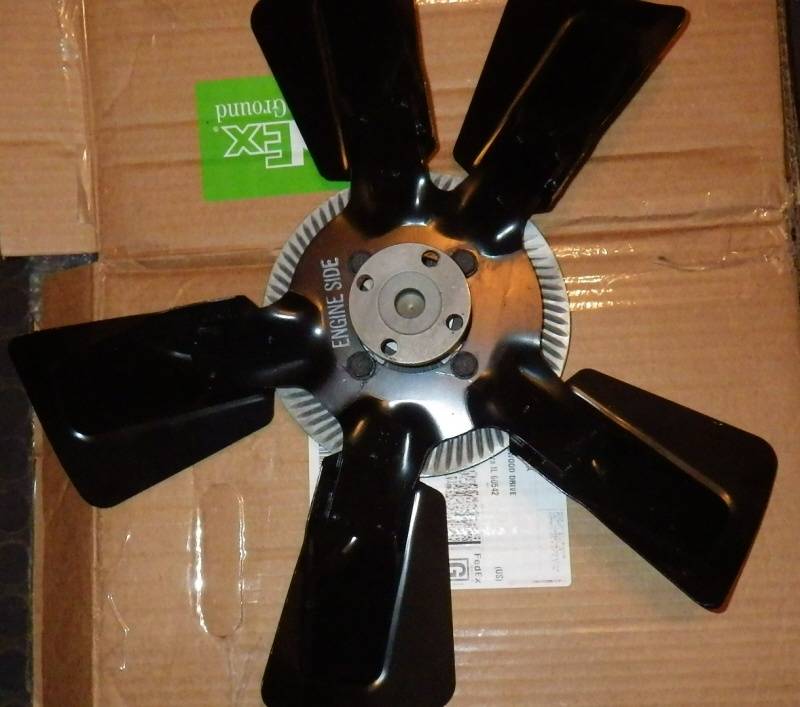

The Fan's rotation and air flow cannot simply reversed or inverted it; must be designed for opposite rotation due to the blade's pitch angle and curvature. The best solution is to consider Tony's Parts, as noted previously. He markets a repro 7 blade fan assembly to use with EITHER a torque drive fan clutch (# 2806070) or thermal drive fan clutch depending on the application.

This is exactly right since the Magnum fan is a direct mirror of the older engines 5 blade viscous fan.

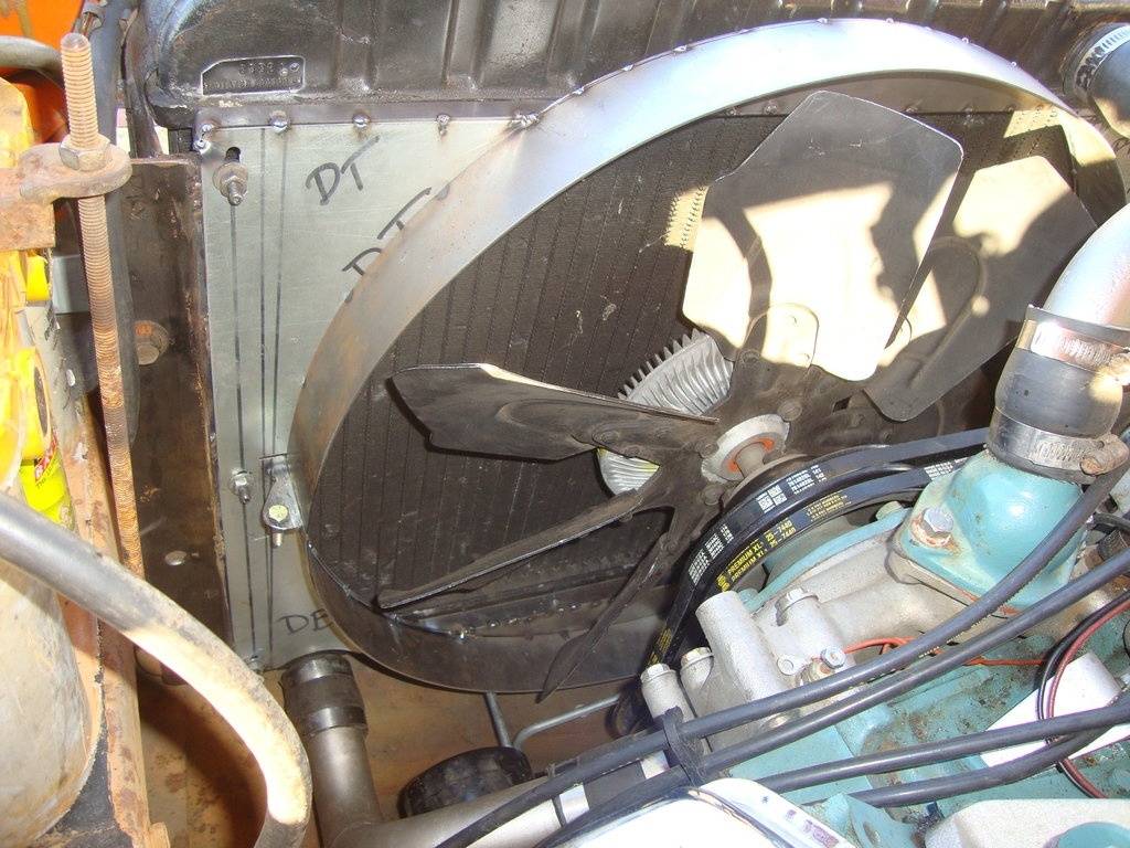

I used one (5 blade) off my 84 Gran Fury LA 318 for a number of years.
My good friend made an aluminum adapter to direct drive from the water pump pulley.
Still have it up in the barn.
