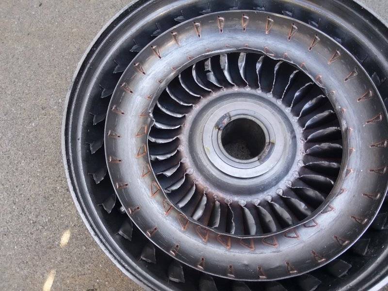

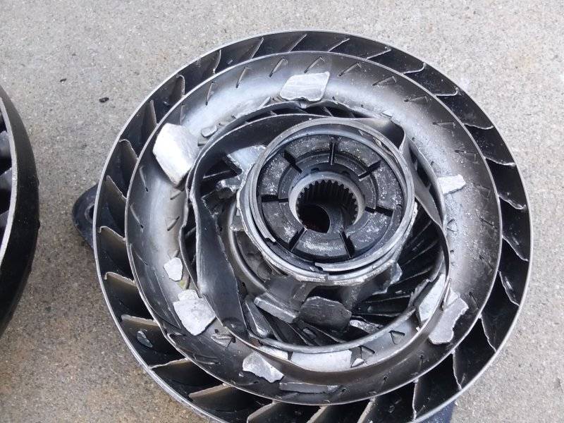

How about this?
Ok, that wasn't me.

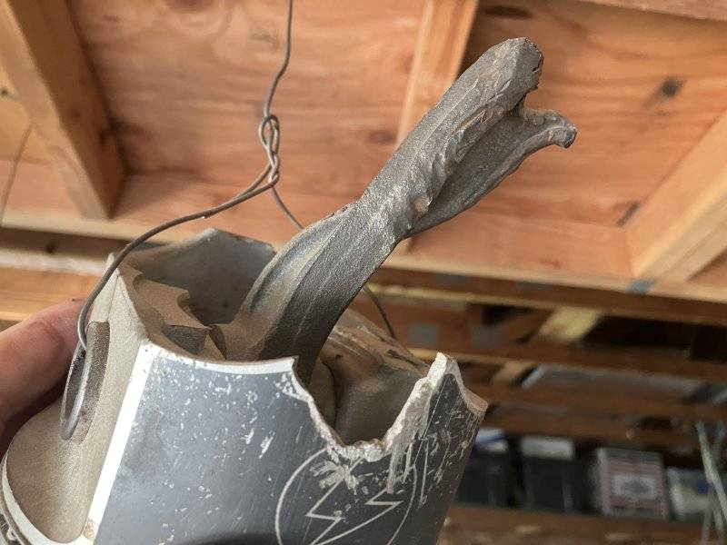

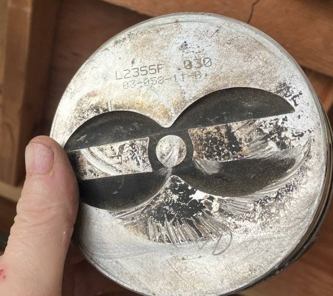

Yes, the rod broke just above the big end. The piston came up and slammed into the head. rotated a few degrees and stayed at about 1/4" below TDC, bending the valves in cyl #2. The big end stayed on the crank journal. It went from 3800 rpms to BAM really quick. I was not in a safe place to leave the car and didn't have a number for a towing service. It still ran so I drove over to my mother's place tucked in a residential neighborhood.
846 miles on a fresh rebuild.
Remember these pistons? Reproduction six pack slugs.
I hang it in the shop so my new engine can learn by example what can happen.
