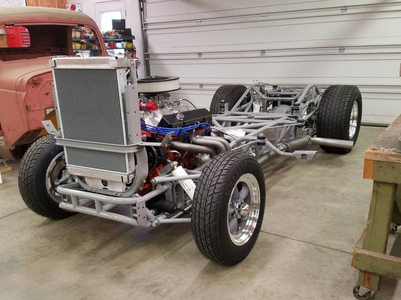

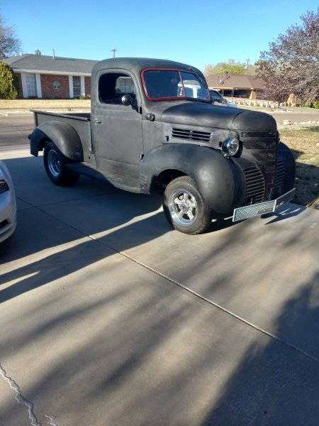

Complete disassembly and reassembly for body and paint.
It took quite a while to build the chassis.
It's all together and driveable now. Just can't seem to muster the energy
to dive into the process.

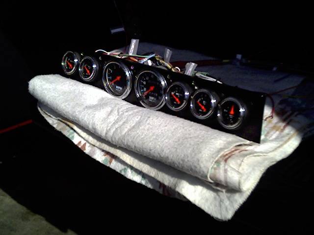

#1 Dash wiring & gauges, new fuse box, I keep putting it off

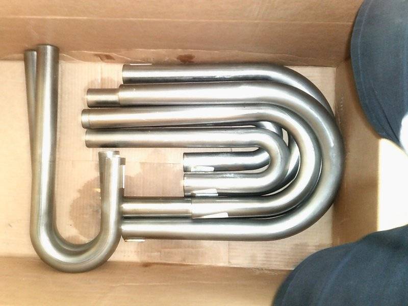

#2 my custom headers build, new Milodon oil pan, keep putting it off
freaken' bolt in rack & pinion was a bad choice, done now no going back
I love how it drives
BUT;
for performance exhaust systems, headers/oil pans options are extremely limited
& pricey
combine this stuff 1-7/8" to 2" stepped to the collectors, as close to equal lengths as possible
using these to start with, be making it like a 63 S/S style iron manifolds,
header probably up & swept up & back, then down the firewall into the existing 3" exhaust

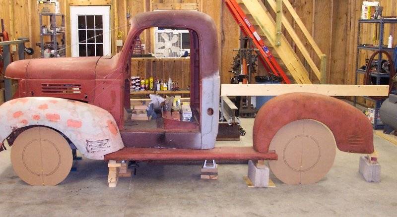

Sure, glad to give you kind of an
outline.

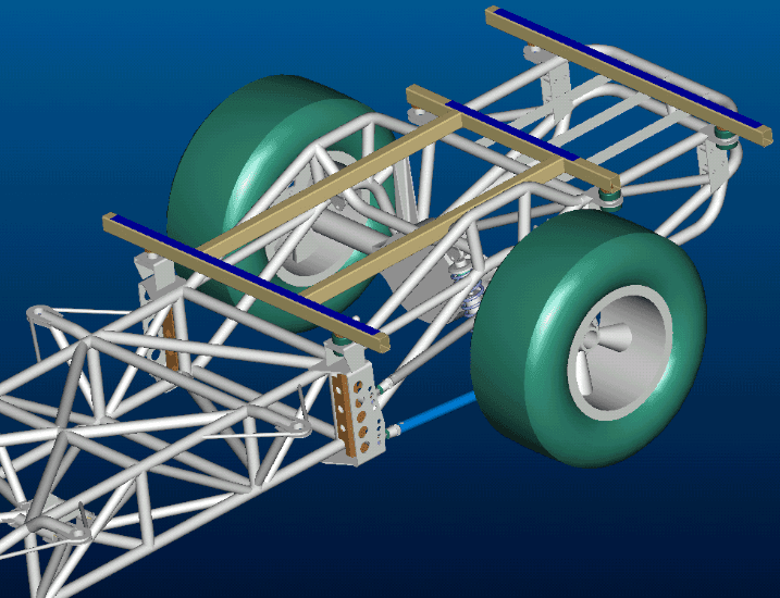

Started out as mock-up using only
the sheetmetal and front rad support.
The original frame was bent to where
it couldnt be reused.
Used the lower support to (new frame)
attaching points as the main reference
for the frame to start the CAD design.
Keeping all parts perfectly level, it was
a matter of setting all parts in place to
locate the cab mounting bolt holes in
their 3 dimensions. (shortened the
wheelbase from 116" to 108"). You can
see the overlap of the running board
under the rear fender. Tire diameter set
the original ride height.
Then on to the CAD design. Attaching
points for; front upper and lower
A-arms, Rack & pinion, shock mounts,
miter box steering, running boards, etc,
set from individual components
dimensions.

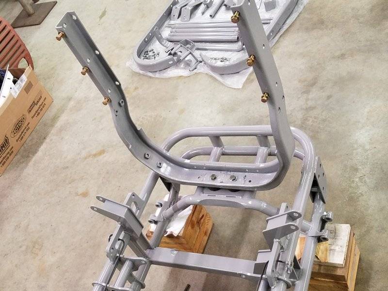

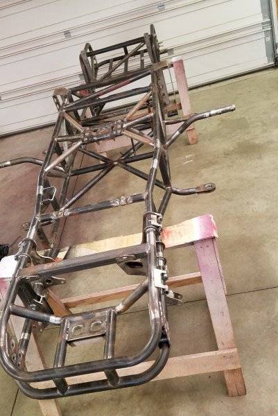

The finished weldment. (note the two
holes in the plate at the front of the
frame). These were the main reference
control points.
After powdercoat with front rad
support installed. At this point the
brake lines were stubbed out to the 4
corners.

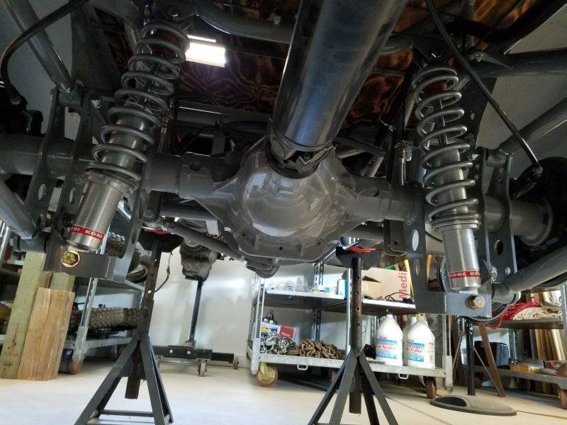

The rolling chassis. (note the PVC
tubing to hold the shocks at ride
height).
The springs were the last main
componets to be installed as total
weight at the wheels is needed
to get the correct spring weights'
frequencies.
