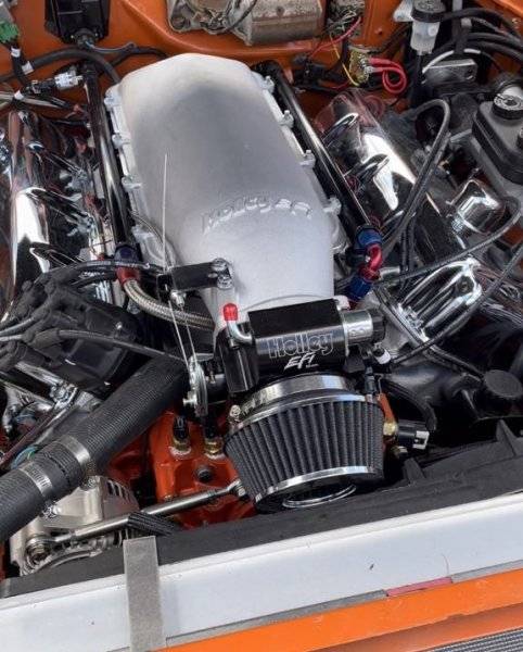

Would the same modifications apply if one was to go EFI with port injection??

In your pic is a gen2 Hemi. That particular modman isn't as bad because the runner length is longer for one reason. On the wedge low-deck I was able to get nearly 5'' of runner length total IIRC which added about 2" to each runner on average.
