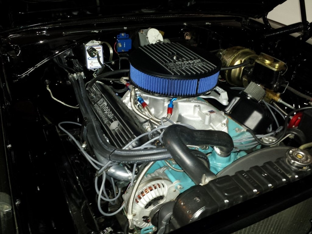

I'm running the Performer RPM on my 440 in my 66 Coronet. Using a drop down base with a 3" Spectre filter. Just barely fits but runs like a beast.
