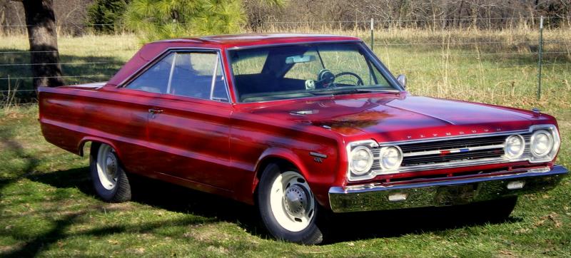

As our 67 gtx 4speed build continues, it's clear that our rear gear is way to low, for our 477, dual quad stroker. Our friend wants it, he's provided many parts for this build, w/o his help don't know if we could have ever got this far. It's got mosier axels. curios about value. Also, IMGP0216.jpgwhat would be the be the best ratio for street use?....thanks Bob
